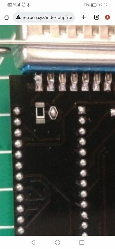

forget diode ,dont install it, if you use it with just usb power, just remove soldier and use external usb power
Edit: this jumper cuts voltage from to amiga to Arduino

Confirming, after removing solder jumper from the four units all four units work perfectly with every MicroSD card tested as long as 5v power supply is connected.

It would be very bad idea to power sdbox from parallel port 5V line. It is only meant for pullup rezistors and very limited. Not even think about it.

Hmmmm, just double checking, are you sure I do not need to solder in that diode? The reason I ask is the SDBox plays total havok with my Indivision ECS - with the SDBox installed the Indivision ECS constantly loses output sync..... as soon as the SDBox is removed the system functions perfectly again. Has me a bit worried to be honest.
Your thoughts?
the jumper gets power from pin 14 and feed
arduino from here, so if you remove solder jumper arduino will not take power from amiga, i am using with this configuration more than 1.5 yeara so far , i have not face any problems
