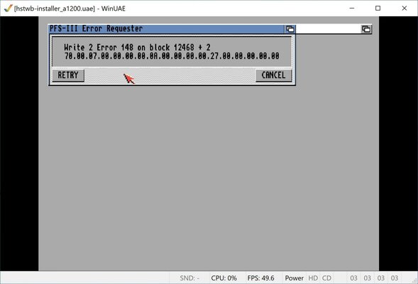

Greetings all,
I'm facing an issue with SD card. After writing my Workbench HDF file created by HstWB installer to SD card (using Win32DiskImager) I'm getting error that the CF card is write protected.
needless to say, I never had this issue with CF cards, I created different versions of WB (3.1.4, 3.9, BettwerWB or classic) with HstWB Installer and all of them work flawlessly on WinUAE or my Real Amiga 1200.
I ordered an IDE to SD card and waiting for my package so meanwhile I can not test the SD card on my A1200.
I would greatly appreciate it if you kindly give me some advice on this matter.
Its the filesystem PFS3 , it will not let you write to it as it has found errors, its a failsafe to stop you ruining rhe drive any further, so the problem must lie in your image or system setup

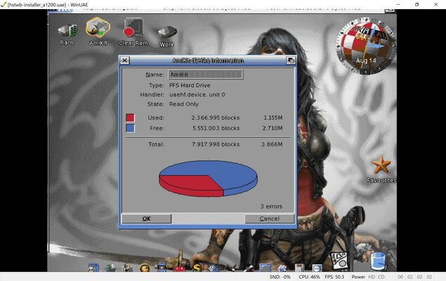

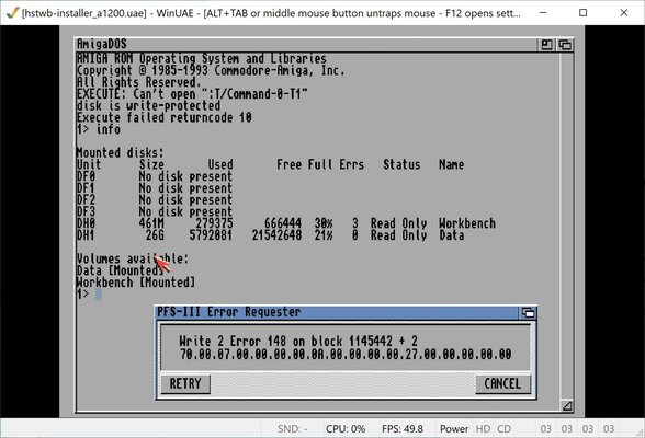

Thanks for your quick respose. filesystem is PFS3, here are screenshot of AmiKit with error, I still get the error message pop-ups but WB manage to boot but both partitions are write protected :
There is no problem with WinUAE setting or Image files that I have, I run WB 3.9 (Amikit 9) HDF file without any issue. but when I transfer the image to SD card this will happen. here is a proof I use the HDF file with WinUAE and everything works well:
This is the screen shot of my HDF file which runs without any issue
This only happens when I use SD card, all of My CF cards with the same HDF image work without issue. As I mentioned before I want to use SD card instead of CF, so I was preparing Amikit HDF file to use on my A1200 :picard
