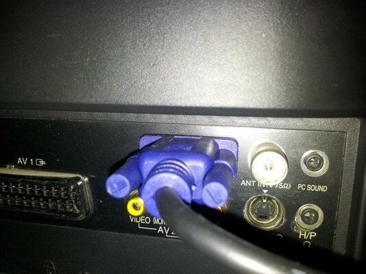

Hi,
i'm sure i need some of you guys help when it comes to getting sound whilst using my 8220.
So, i'm using my gbs 8220 on my samsung 32" lcd tv which is my older tv which has red/white audio inputs.
I get a very good picture with 8220 on pc vga channel but no sound. So i link up my red white cable from the amiga to the red/white audio in ports on my tv - no sound. (Infact i try all red/white ports on my tv - no sound)
What am i doing wrong? Should i be trying to use the red/white phono cable from the 8220 ports to the tv rather than from the amiga to tv? There are no red white ports on the 8220??!
How is everyone else achieving sound through using their 8220 ?
(I've got no chance of using my 8220 on my new led tv as it has optical inputs - a technology totally beyond the amiga??)
Any advice?

aha got it johnim, thanks so i got it working by using phono cable to the audio in next to the vga port (which is a 3.5 mm jack)
The main reason why i was having difficulty was due to my tv being wall mounted, i didn't want to take it down just to plug the cable in, got their in the end.
