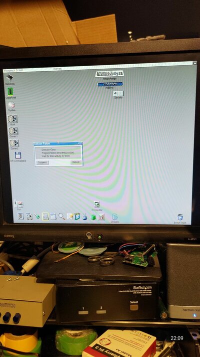

Done a little more trialing of the Mediator, sorted the error issue out by starting from scratch again and the Mediator 1200 PCI works great with config = Closed and 8mb = Closed so
@Rontti this config should work great for you
Now onto the mediator 1200TX setup: config = Closed if left open the TF1260 card is not seen in the Amiga boot menu but it still seems to load up.
4mb = closed everything seems to work correctly
8mb = closed Amiga boots normally but graphic glitches occur Amiga does not crash though to me it's a memory conflict which is the cause of the issue see screenshot below.
Just to confirm MMULibs is also installed it made no difference with it not installed
I also noticed that when the mediator is set to 4mb it thinks it is an SX but when set to 8mb it states it as a TX
Anyway it's been fun testing these and maybe a future update will sort the issues we are getting in the mediator TX when set to 8MB
