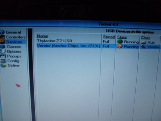

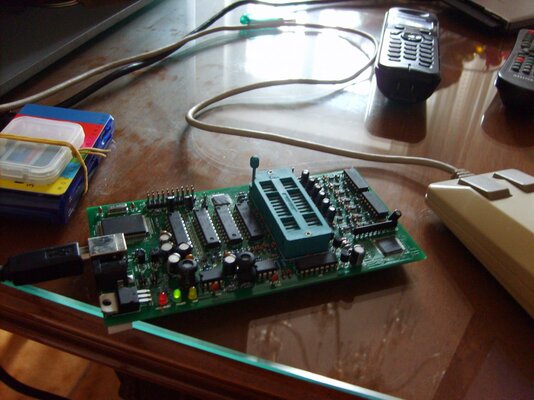

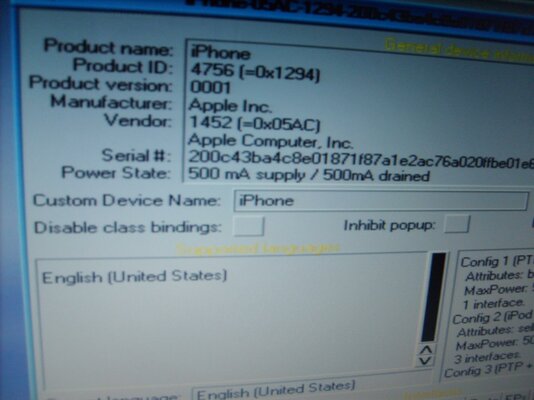

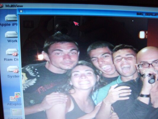

Finally I have plugged an iPhone and loaded some photos on Amiga without problem. Also I have tried my Universal USB Programmer: Poseidon have see it but of course without drivers it is useless :(
I think Thylacine is a good card used with Poseidon 4.4, using Poseidon ROM Tag utility, after every reboot, devices are immediatly actives.
