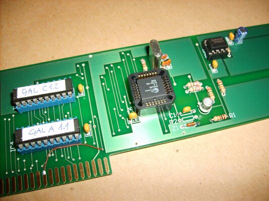

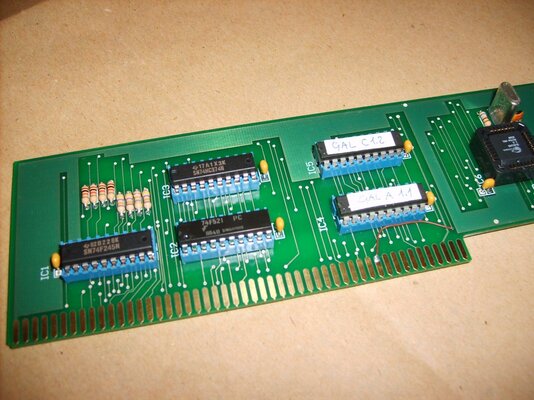

Well than one part from you and another part from down under :-)
Don't worry, insert some chips and make 6 solders is very very easy. Even my mother can do it ;)
This is Robert's kit. Square socket don't is needed because I will include it in my board.

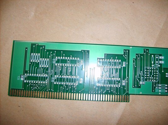

Uuum, maybe it's not a quite good idea, to produce a design with obvious problems... Well, I hope, you will be successful and everything is working fine.
22/12/2012
Thylacine USB is alive again!
High Quality PCB with golden plated contacts!
Soon a FOR SALE Thread!
Only 9 boards, for the moment, so you MUST be a FLASH!
Really great news... and great job!! As I said into a previous PM, I'm interested... now for a future production!
crasbe: what do you mean ?
Oh, there are serval problems, I think.
Both USB-Lines (DP and DM) are too far away from each other. The idea of differential potentials is missunderstood. If DP is high, DM is low; when DP is low, DM is high.
This behaviour protects the data against electromagnetical influences.
DM- and DP-traces are about 15cm long, but about 3mm separated from each other. Better would be about 1mm or less.
Also: Why is there no shielding on the opposite side of the traces? They are completely free to send and recive em-fields. Nearly no protection. :roll:
The power-supply is also not quite good IMHO. It's absolutely NOT state of the art. It is 70-80's style...
Also there are serval known fixes, you could edit it in the gerber-files.
