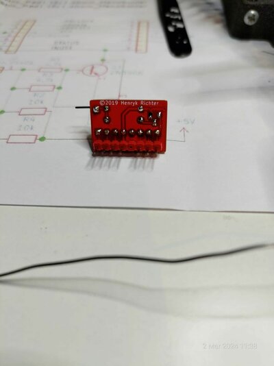

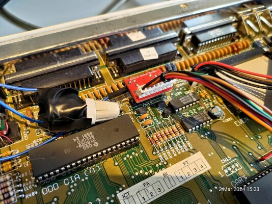

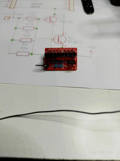

The keyboard has been refurbished with a PCB membrane and I got a kit from eBay which I soldered up. This adapter allows the floppy drive Activity LED also show the HDD Activity.
These kits are sold to work with the CF to IDE adapters and it does work flawlessly with them however my SD to IDE adapter just made the LED stay on but I found adding a 10k pot to the line made it work.

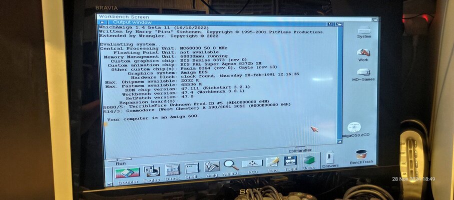

Spec:
A500+ with 2mb chip RAM in trapdoor expansion.
A570 with SCSI interface
Kickstart ROM 3.2 (47.111)
Extended ROM 2.35
TF536 with 32gb SD card SD card extended outside of case.

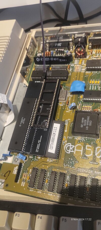

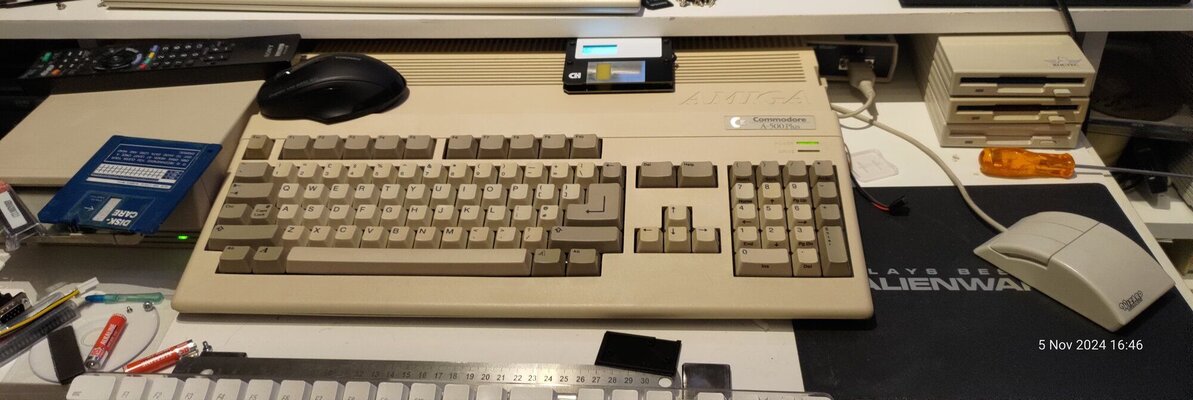

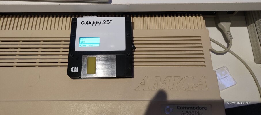

Added a Gofloppy V2 and a Garlic CPU switcher to the system
just got to find a rom switcher to allow me to switch to Kickstart 1.3 when using the 68K and Kickstart 3.2.2 when using the TF536

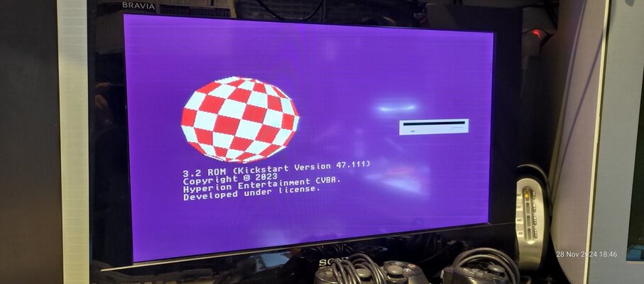

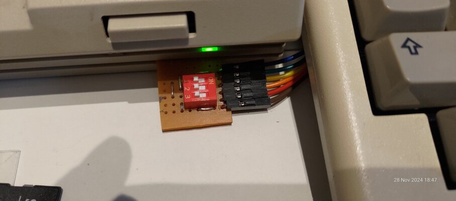

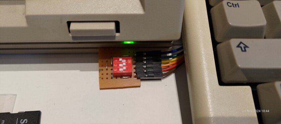

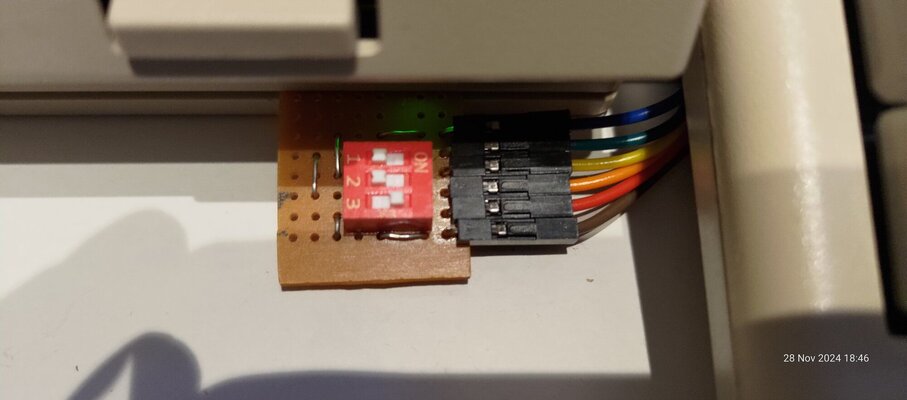

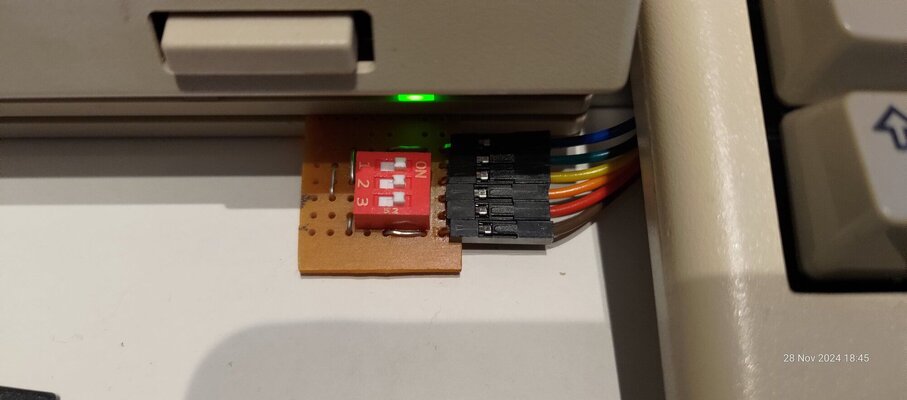

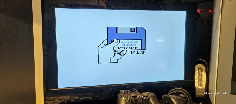

Think I have got it as I want it now.
With the addition of a 4 programmable Kickstart I now have the ablity to switch between The following ROMs 1.3, 3.1, 3.2, & DiagROM
using a 3 way dip switch, Switches 1& 2 set in certain postitions select the ROM I Require and Switch 3 selects the CPU I wish to Start up with.
I did have to trim down my Garlic CPU Switcher to allow the Programmable Kickstart ROM to fit in the Kickstart Socket its a tight fit.
Set with Switch 1 on and 2 off = Kickstart 1.3
Set with Switch 1 off and 2 on = Kickstart 3.1
Set with Switch 1 off and 2 off = Kickstart 3.2
Set with Switch 1 on and 2 on = DiagROM
Set Switch 3 on = 68K and off = TF536
