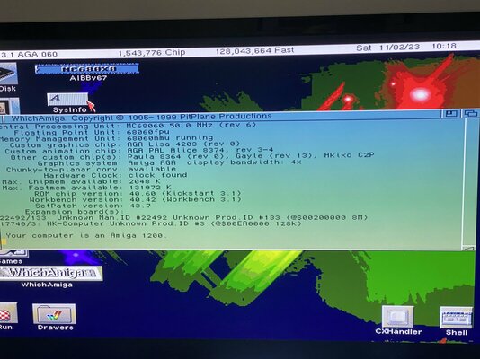

I had to remove the FPU in mine It would load up to workbench but it would crash when starting certain programs so I removed it thinking the FPUs were fighting each other, don't know if this was the case but it stopped the crashing.
What is the 22492 I'd for? If this is your TF360 it seems to have a different id to mine, is there a newer firmware for it. Looking at it now it seems to be the promodule 8 mb side but why the different number.

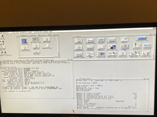

Now my question for you is Elsat IDE what are you using on that and how did you set it up? I can't seem to setup the drive on it old hdd or new cf
If USB works it would be awesome, this is really the last hurrdle that stops the CD32 from truely matching the A1200 in terms of basic functionality, I’m guessing a USB network adapter under something like RapidRoad would probably run rings around the TF’s ESP8266 WiFi. It would also just be nice to see Poseidon running on a CD32 for the first time. :)
In answer to your question, I think in order to use the internal IDE you must first use HDPREP the from the Pro Module’s installation disk rather than from HDToolbox, I vaguely remember someone saying that the Pro Module uses Elsat’s own custom IDE controller technology that they originally developed for their Zorro memory/IDE cards. I think this also means you can’t have big HD’s on the Pro Module and there is a 2GB limitation, I might be mistaken so someone please correct me if I’m wrong.
Those two address spaces appear when I have the Pro Module’s 8MB Simm enabled, one address is the Pro Module Simm, and the other seems to be the Pro Module expansion itself, for some reason when I run this configuration the TF360 is not being reported but is still present and functional. If I disable the Simm then both the Simm and Pro Module vanish, but the Pro Module is also still funtional.

I attached a couple pics of Workbench under the Pro Module and contents of the installation disk and IDE to SD adaptor installed.

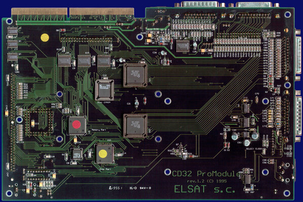

Hi ppl.
Did anyone of you recapped this board? Timtheloon, Akiko80 ... ?
Found that almost all SMD caps have wrong polarity - soldered other way around.
C21, C22, C25, C26 & C92 have + pole on ground.
C93 is properly connected - minus/black mark on ground.
C94 has no direct contact to plus or minus/ground pole - think to solder it as is.
C21, C22, C25, C26 - are on my Rev 1.1 47µF, on Rev 1.2 they are 10µF.
C92, C93, C94 are 100µF on both revisions.
What did you do? If anyone already did recap?
Shall I do it right - minus to the ground? C 21, 22, 25, 26, 92.
Change capacity from 47µF to 10µF? Or leave it as is - saw on Rev 1.2 there are on some places bigger + extra kerkos (Ceramic Caps).
Thanks in advance.
greetz,
Miron
I've not done a recap on mine but now you mention it, its on the cards for me to do.
There are differences with the 1.1 & 1.2 maybe that's the reason for the different caps
With regards to the whether they are the wrong way around need an electronics expert for that maybe someone like @hese could give us his opinion?
The rev is written on the main PCB of the ProModule if you look at the one on Amiga Resource it is V1.2 so when you unpack it we will see :LOL:

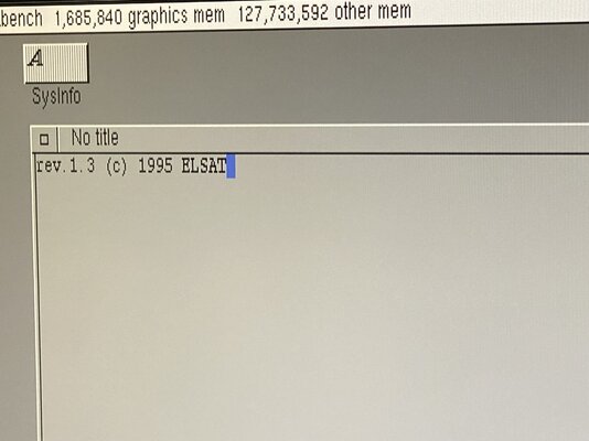

I Just noticed if you open a text editor or shell and press the pause/Break key on the keyboard the ProModule appears to spit out it's board revision.
I'm not sure if this readout is available on all revisions, or something added later.

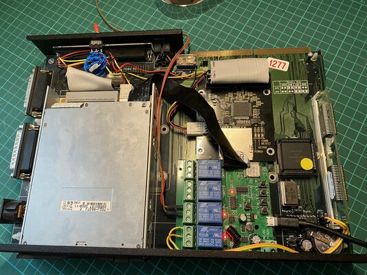

I have one of these promodule units. It has been a little unloved and then I became its latest custodian.
I have a TF330 hidden away. Also the promodule's riser is damaged but I need to find it as it has vanished in my stuff.
From what I can remember there is a small amount of damage to some of the data lines...
Yep mine had a similar problem with the riser, are you gonna go for the repair yourself @ElectroBlaster or get someone else to do it?
Maybe we should look into PCBway to get new ones made 🤔
I am not sure yet. I need to locate the riser, it has vanished in all my stuff! I did go through the main unit, tidied up and reseated the disk drive, replaced
manky screws etc. But I have more problems there is a relay near the power input and the cover for that is long gone! I did try searching for a replacement relay but initially could not find the exact one, but something that appeared to look the same.
Maybe I should fish out the promodule and grab some pictures of it all.

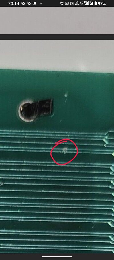

Played around with the Promodule just now and it's for sure something with the riser because I can wiggle the cd32 and in certain positions it will boot into wb.
I think maybe the edge connectors might be bad?
Can you change them out or do you think it might be track damage?
upload pictures of the riser
the fact it works when you wiggle it does seem more like a bad connection
@screemo use to sell the edge connectors for the CD32
looks in better condition than my one
only one area of concern
