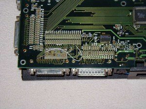

wondering if anyone knows anytihng about this 'floppyfix' image i found on an https://bboah-hardware.de/cgi-bin/showhardware.cgi?HARDID=275. odd that it doesnt show up on the english ersion of the site....
Hi @AdaptiveSystems
My board has that floppyfix but I believe it is just to fix my revision of board which is a 1.1 is yours a 1.2
looking at the main BBOAH page you can see that this is a rev 1.1 and this is probably why the floppy fix is there.

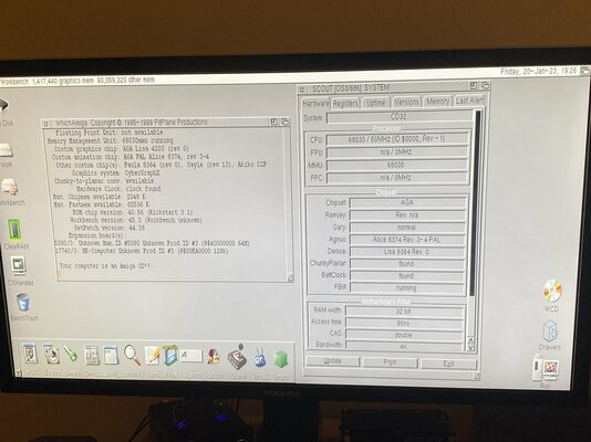

Forgot to add a screenshot of the system up and running with a WhichAmiga display. Even though it thinks it's an A1200 you can see the Akiko chip and the two board ID's for the ProModule (Uploaded to first post)

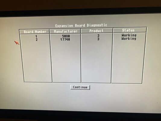

@Akiko80 interestingly yours shows both cards in play in the boot up expansion menu mine will only show either the TF360 or Promodule depending on what the memory switch is set to.
Memory On = Promodule indicated. Memory Off = TF360 indicated, however they still both seem to function fine together whichever way it is switched just the 8mb goes off or on has expected, drive and ports still function
