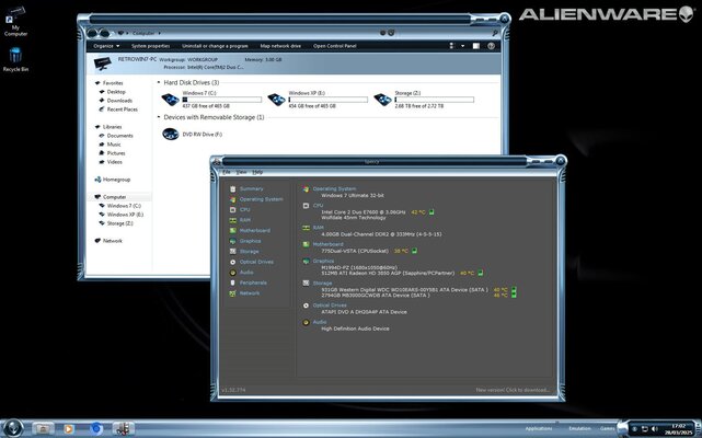

So I wanted to making a high-end 32bit Retro AGP Windows XP machine and ended up with a dual boot Window XP and Windows 7 Machine

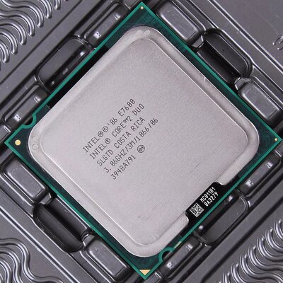

Now for the Motherboard I went for the ASRock 775Dual-VSTA which surprisingly supports both AGP & PCI express (This is obviously limited to older PCIe cards) and added an Intel Core Duo E7600 processor to it which was the second best I could find and within my budget :p now I did find after purchasing this motherboard that it has a bigger brother which supports quad core CPU's but they are in the big bucks and blew my budget out of the water.

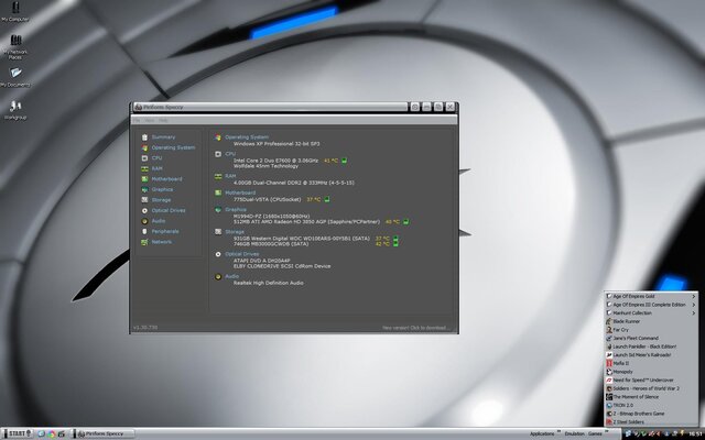

I have two SATA drives fitted 1x1GB and 1x 2GB the 1GB I have made 2 partitions for windows XP & Win 7 for a nice dual boot machine to allow for retro gamming across both OS's supposedly this Motherboard will also work with windows 98 but I haven't attempted that yet but so far it is playing all the games I wanted it to play

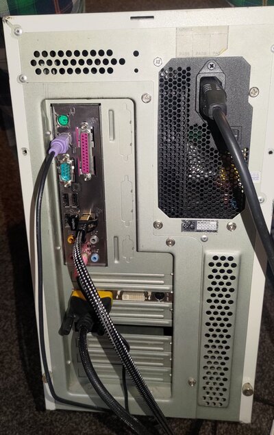

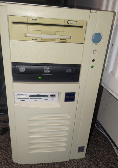

I have put it all into an old Pentium II case which it fit very nicely into and it adds to the Retro look it has a few knocks and paint chips but it adds to the look IMO.
I will find a White DVD drive to give it a better look but the black one will do for now.
The twin floppy drive sadly needs attention the 5.25" 1.2mb drive seems to work ok but the 3.5" 1.44mb is a no go it looks like capacitor damage is the reason why this on is not functioning.

I'm a fan of the old Alienware themes if you are wondering why they are there.

The old games are working great so far, only "Jeff Wayne's War of the World" is the first game I've come across which fails on game start. loads all the intros just fine.
