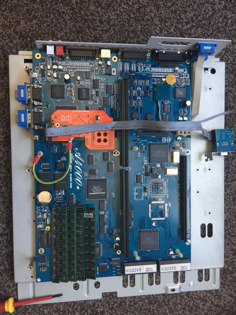

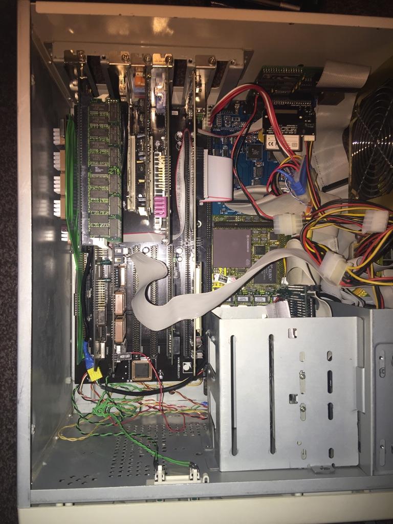

Hi all I would like to share my A4000cr build with you guys
So here is the spec
A4000cr Alice motherboard (@hese creation) with 3.1 kickstart roms and 16mbs fast ram installed

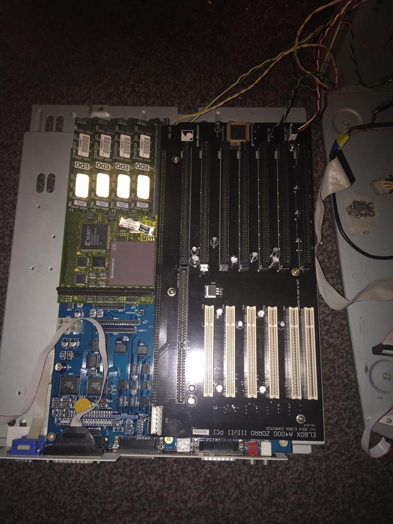

Cyberstorm MKII 060 rev.1 @ 50mhz 128mbs fast ram
Mediator 4000D MkIII
Indivision 4000D/CD32 MkIIcr with Ratte Auto Switch
Zorro cards:

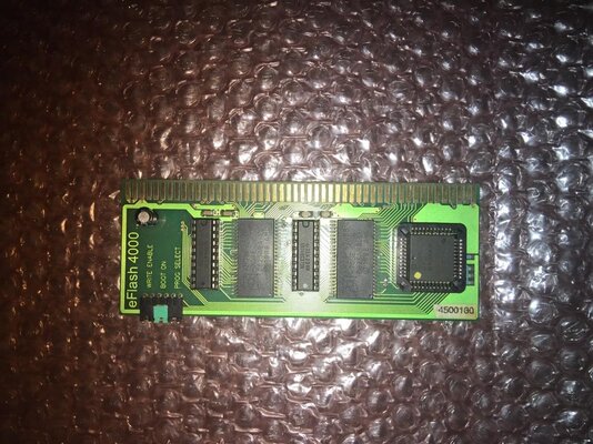

Elbox 2mb eflash

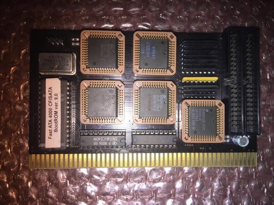

Elbox FastATA 4000
Hypercom Plus
PCI Cards

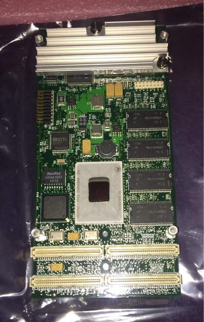

Apocalypse G4 7410 with 128mb
Voodoo 3000 or ATI Radion 9250

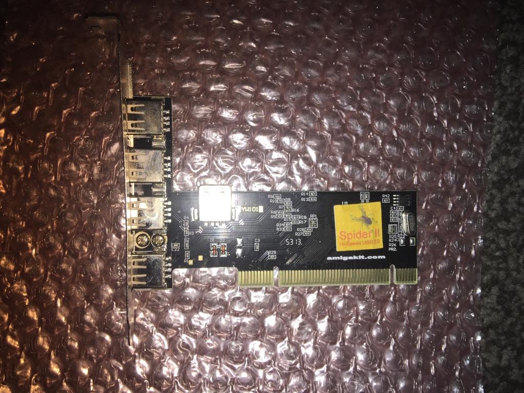

Spider USB
SB128
Pci Network

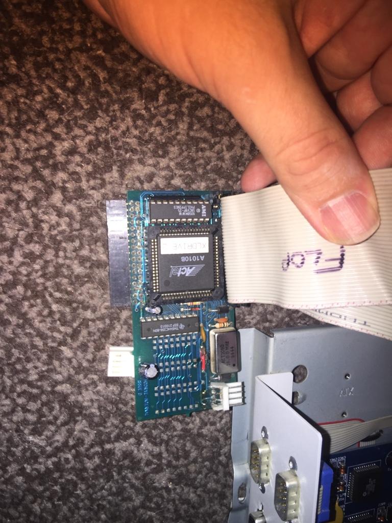

Extra is the catweasel not install quite yet which will connect to the Samsung 1.44mb floppy drive with built in USB Card readers

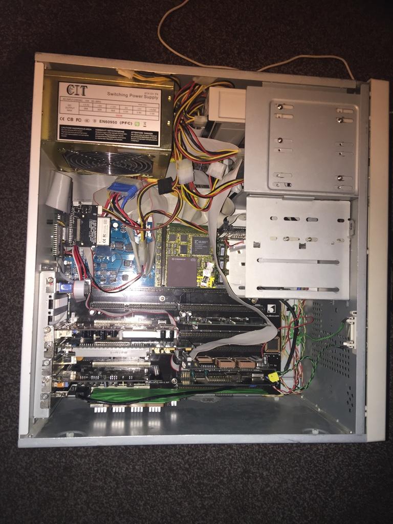

The case is a power computing version of the Elbox case
LG DVD drive

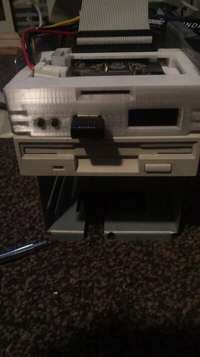

DF1: Sony HD FloppyDrive with power computing XLdrive internal Adaptor
DF0: Gotek in 3D printed case with SD Card internal IDE

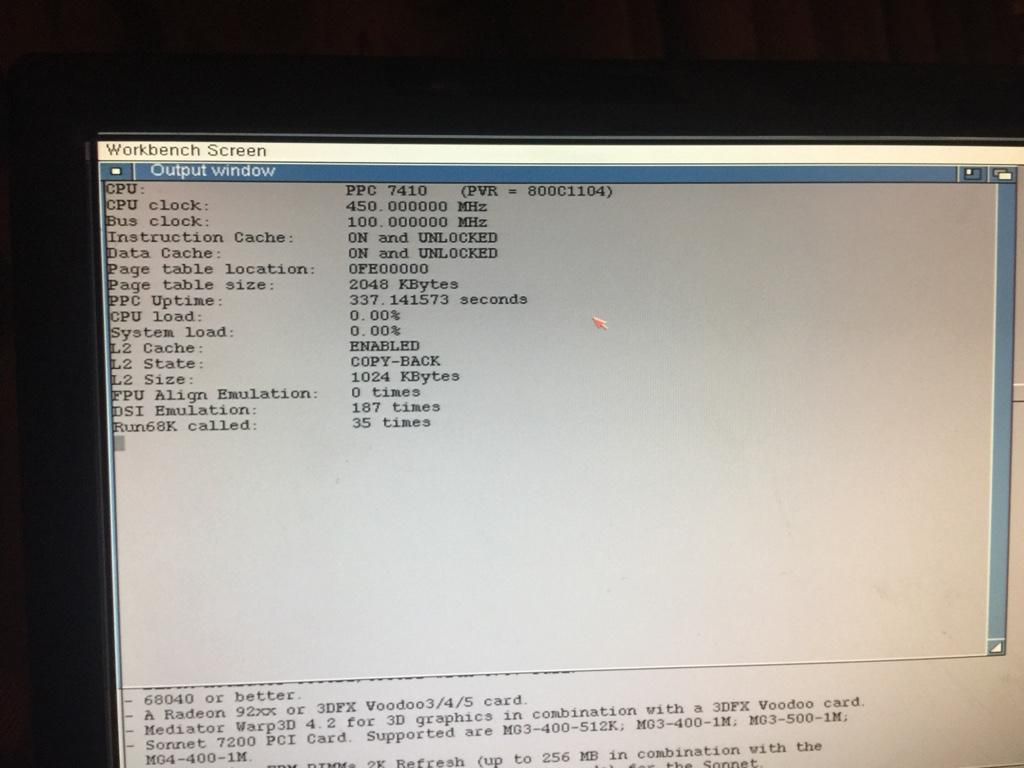

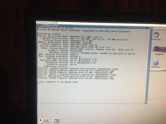

Some speed results
This one’s for you @fitzsteve
A big Shout out for a few members who have made this possible
Thanks hese for the amazing motherboard recreation/manufacture
Thanks fitzsteve for helping with some configuration issues
Thanks grelbfarlk on EAB for helping me setup the Apocalypse and get it showing the correct memory of 128mb
Thanks dooboos for his 3D print gotek and SD 3.5" bay
