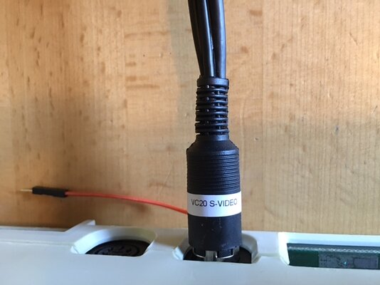

I need to get the chroma / luma cable 1st. Then I'll build and post to you next week. I PM you the PayPal details, but you already do know them.
Received my kit yesterday but there were no instructions on how to install.
I assumed the pictures were sufficient. I now added a text to post 1.

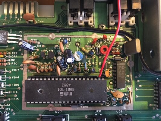

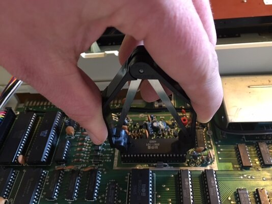

Remove vic-I chip from socket
insert mod into socket
Insert vic-I chip into mod
Done

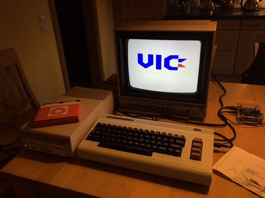

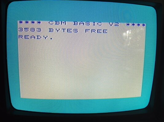

Hi mrr19121970,
many thanks for shipping that fast!
I have installed and tested the mod and you didn't promise to much :wink:
Definitively a must have mod!
Commodore Monitor 1701 / 1702 Rear Connector:
VC20 Connector:
Without Mod / Original:
Extract Chip:
Insert Mod:
Insert IC:
Check System:
& enjoy ;-)

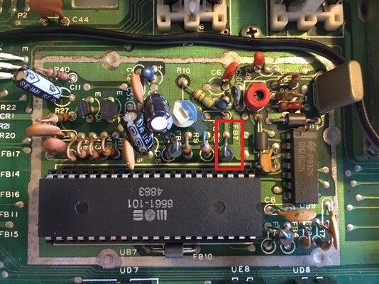

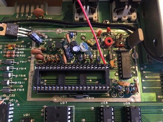

Feedback exchanged. Sadly @botialoach has discovered his VIC-I is soldered onto his mainboard and not socketed (which is a prerequisite for the plug'n'play part)
@botialoach ideally you need to have your 6561-101 desoldered from the board and have a socket inserted. If you can't do this yourself and you don't know anyone that can help you, then there is 1 alternative. This is no longer plug and play, but it reversible and the chances of damaging your 6561-101 are less. With sharp needle nose pliers snip the FB7 (or desolder and keep safe). Now snip the RED wire on the mod, and solder this directly onto the leg of the snipped ferrite bead next to PIN2 of the 65101 (or the hole if you desoldered).
You do this all at your own risk.
