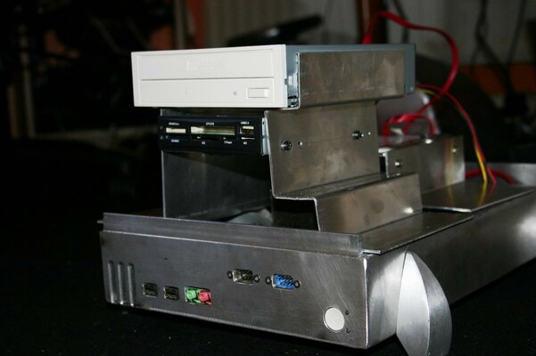

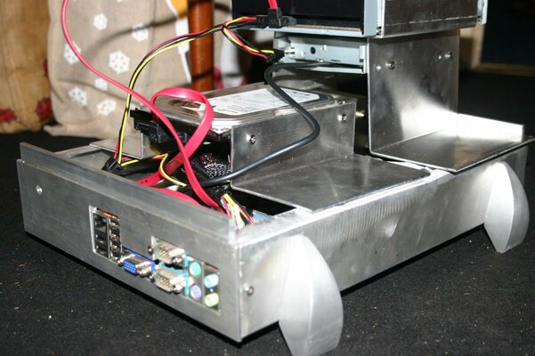

well now things are getting serious,
instead of a floppy drive i'm going to have a card reader, it needed to be the same size as a floppy drive so i put this card reader into an old floppy drive case :)
just test fitting the brackets, need to "ventilate" them, straighten/level them up and fix into place.
joystick ports are in as are the power on/off button and power/hdd leds.
still a long, long way to go:)

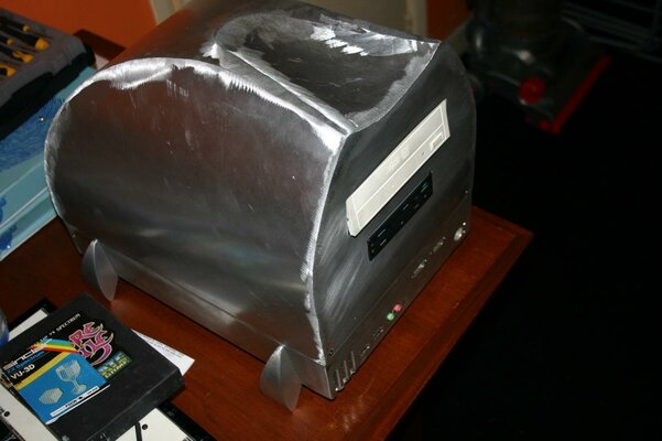

ok, so it looks like there is just filling, sanding and painting left to go:)

This thread deserves Legendary status; I've moved it to the appropriate section.
Have you decided on a final paint colour yet, Justin?
