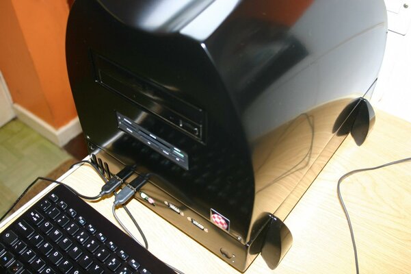

remember i said the case was ready for painting? well i was wrong:lol:
so after a lot of filler and sanding, it is now ready for painting:)

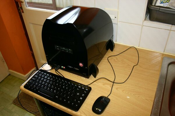

WOW!!!!
all painted up and ready to rock:)
please don't look at all the dust/dirt, it's only just come back from the bodyshop:oops:
WOW!!!!
Masterpiece! :)

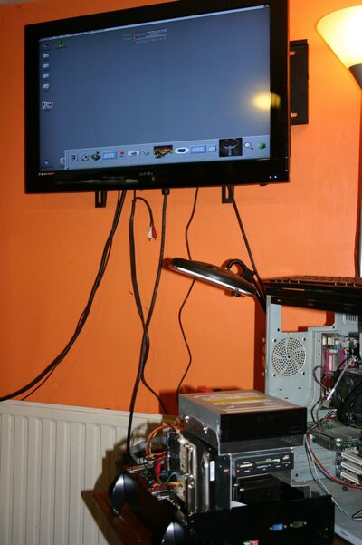

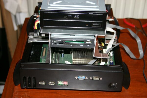

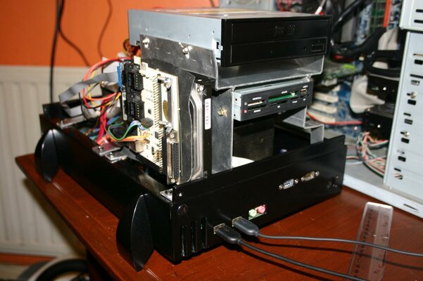

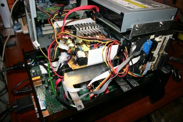

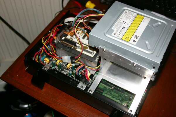

Well upon assembly and testing i came across a major stumbling block, the
fujitsu mobo is proprietary as is the PSU :(
not sure how i am going to draw this........
13| 14| 15| 16| 17 | 18| 19| 20| 21| 22| 23| 24
3.3| -12| com| pson| com| com| com| x| +5| +5| 0| .06
1 2 3 4 5 6 7 8 9 10 11 12
3.3 3.3 com +5 com 5 com pwr ok +5 12 0.4 0.3
that is is pin out from this PSU hopefully you can see that this is different from a standard ATX :(

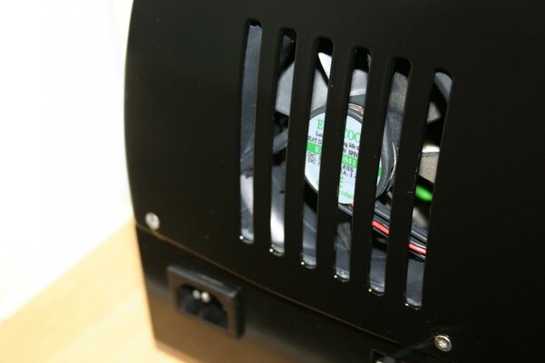

solution, strip down the original PSU, extend each cable one at a time (original atx connector wires were only approx 2" long) to approx 10" then move the IEC connector to the back panel.
in order to do this i had to move the internal around quite a bit, but now it all works:D
here's some piccies of todays updates
cheers, Justin
