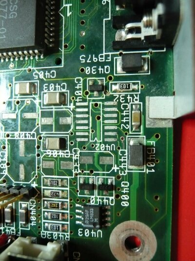

If you recall, my brandy-new a4k had some pretty decent cap damage, as well as a touch of battery leakage. This area is a bit worse than the other 3 areas, so I'll focus on it in this thread:
attachment.php
The first step was to pull the leaky caps off, and give it a lemon-y fresh treatment. Things are starting to look not too bad. Though, U402 still bugs me a bit, as do the resistors next to U403:

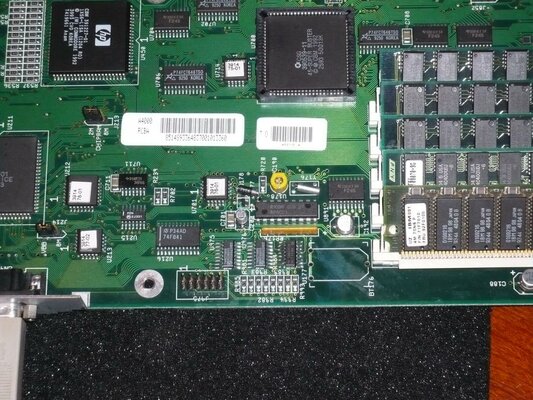

And, after following the troubleshooting guide on the Amiga Technical Resource for troubleshooting the RTC, all the connections look fine, which means that it's either the RTC itself, or the latch (U177). Since U177 was somewhat fuzzy before, I bought a replacement and pulled it. Looks good too! (I did clean the PTHs for the battery out after I took this shot):

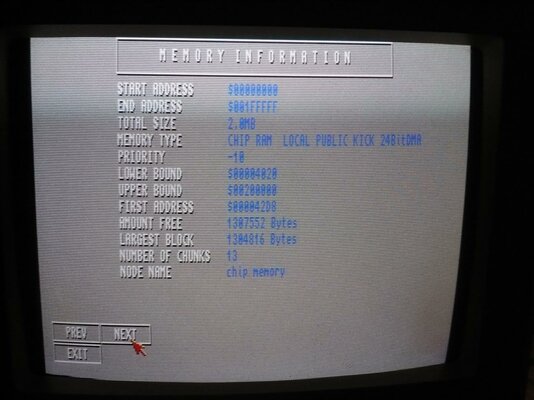

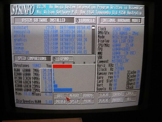

Today, I wrapped up the intensive soldering portion of my fix-up by recapping the A3640, and decided to take some pics to show my progress, and keep the AmiBay hardware pr0n hounds at bay...

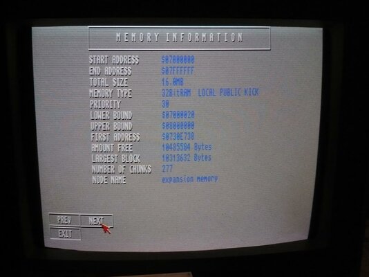

First, some success shots. Note that the RTC is recognized, as is the full chipmem and fastram. Whee!

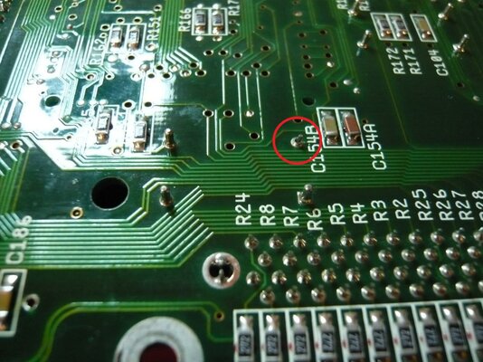

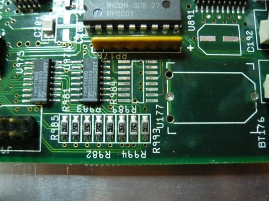

Now, some closeups of the work. First, the U177 area that I botched the first time. I'm still contemplating solutions for the replacement battery. D0pefish's idea is pretty cool, but I've got a couple of other ideas brewing...
attachment.php

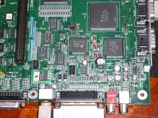

Next is a shot of the audio section, showing the shiny new caps, and new LF374 in place. Sounds sweet:
attachment.php

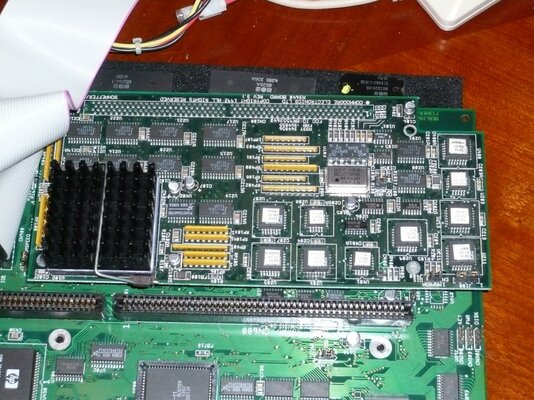

So, I was bored, and doing some reading up, and it looks like my a3640 suffers from the reversed-cap issue on C105/106/107. That's too bad, given that I just replaced them. For some reason, I thought that it only affected the rev 3.0 boards, and they fixed it in the 3.1 on, which is what I have.
Can someone take a look at the pic above, and confirm? It seems that this would be strictly a screenprinting issue; any "fixes" that C= would have made would be in the silkscreen layer, and subsequent component installation, not in actual copper revs. So, it should be pretty easy for anyone to tell whether their caps are reversed.
But, yes, I did do a continuity check, and I have zero ohms between ground and the (+) side of each of those 3 caps...

Hi fella. :)
RE: your A3640....
I've tried zooming your pic to look at U209 & I can't be 100% sure what it says. However, if that U209 chip label ends -03, your Silk Screened Rev 3.1 A3640 is actually a Rev 3.2 :)
Also, see here for correct orientation of Cap Replacement which applies to all 3 versions of this board.
http://amiga.serveftp.net/A3640_capacitor.html
You can always check polarity yourself. I'm sure TheCorfiot did this on a card I supplied him with some time ago.
Kin
Simple: set the multimeter on a DC scale which can cope with 5V, then check the voltage and polarity directly on each capacitor.
@kin hell - It's a rev 3.1 (-02 GAL).
@rkauer - Yeah, I've done the resistance to ground check, and am fairly certain they're reversed.
