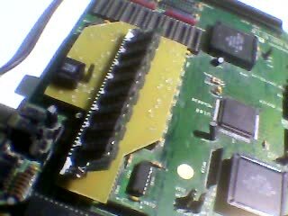

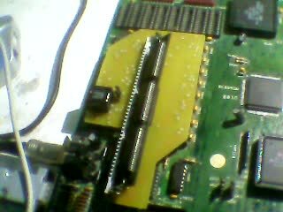

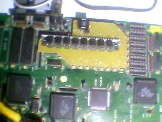

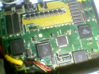

Hello,
there is for sale two new adapters, with logic, at 40 Eur/piece (without memory simm) + postage. Take a look at the pictures: i can't guarantee that this adapter, equipped with a common simm, fit on a A3000D motherboard in an original case, because the simm socket's degree is about 45. Can be that diffrent type of simm take different room inside the desktop case.
If you are interested, please, read all the post of this thread, to know exactly how it fit onto the motherboard and how it work.
About old sale, can be that someone of you has received this adapter without logic and the buyer has failed to make this device working. Can be that i have make erroneous assumption about this configuration and your adapter need the logic to work properly. If that, please contact me!
And last, i wish to remember that, if you are interested, you not pay for the content of the logic, that is freely downloadable here on Amibay, but you pay for my work, to realize this device with his own design: the most common CPU card for the A3000 fit correctly with this adapter, even the A3640.
