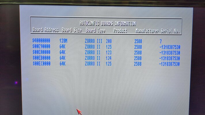

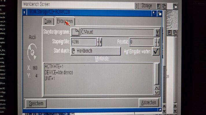

In need of help connecting this card to a CDROM drive.
Jp1 closed for lide? (I've tried open and closed)
Devs/Dosdrivers CDO SCSI.device changed to lide.device
LIV2/life.device/github mentions that..
"CDFileSystem from AmigaOS 3.2.2 (should be) loaded with LoadModule"
If this is needed, can someone kindly inform me how this line for startup-sequence is written/formatted? (I've tried a few variants without luck)
Sysinfo (and showconfig) looks like it shows the card and the dicke Olga.
Thanks in advance! :)

If you are moving the jumper onto the on position, then it no longer uses lide.device. Instead it goes into scsi.device. In your instance it becomes 2nd.scsi.device as you have 2 x IDE ports. One on the mainboard and also the card.
Get hold of idefix97’ off Aminet. Use the FindDevice program to scan what it sees on each device detected.
As for CDFileSystem by using LoadModule. I haven’t done that. But if you get hold of IDEFIX97’ and install that in Export Mode, then it will help you identify where the CD device is and create the correct mountpoint for you.
I am using Mount program instead of Loadmodule
You can see unit number of Your CD-ROM if You run HDTOOLBOX (pit a CD in it, otherwise CD-ROM will not start), and add this unit number in the tooltypes of Mount
