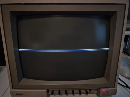

1084 and collapsed picture *fixed*

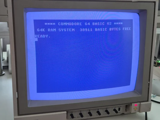

Still working great!
Maybe the picture is tilted just a little but I think I'm not going to do nothing about it, it's so minor.
Another thing is that it starts to bloom quite easily, if contrast is in the middle it's already blooming a little. If I set contrast a little bit lower it's fine.
I made the recap of my 1081 monitor and after first power on the problem with vertical collapsing seemed solved, but I had flashing and intermittent red lines on the screen (see the photo).
At the second power on the red lines continued but again I had a verticale collapse as in the first pic of this thread.
Do you have any suggestion of what could I check?
