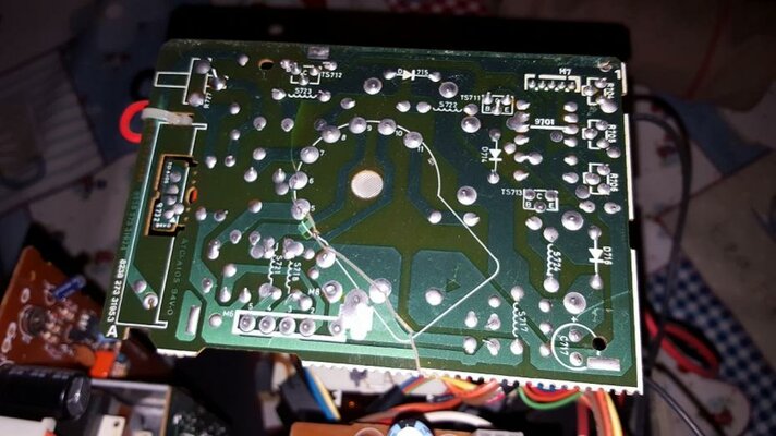

Mine arrived yesterday, well packaged but unfortunately it was broken in the back.
The pcb in the back of the tube is broken in half and the back plastics are broken as well.
Irix already filled a claim with the shipping company.
Does anyone has this part as a spare? Probably will need to source this part from someone who has a monitor for spares.
Well You could glue the pcb back together and than go trace by trace and solder single wires to ends of the traces - just a quick fix if You dont have spare part. It will work if you connect all broken traces

From the picture You posted looks that it wont be hard to fix it. If tube is intact and everything else is good. Do what I wrote in firs reply. Traces are huge and You can easily determine which solder point goes where
Hope You will fix it

Thanks all, please leave the topic open for support of the damaged monitor, still working on refund through the shipping company. Sent extra pictures yesterday to them, on request.
