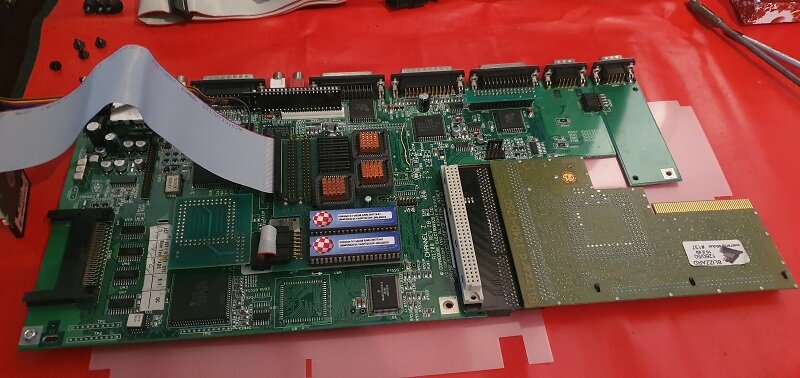

Hi All,
Been a long time since I shared a project, almost going full circle here with this one!

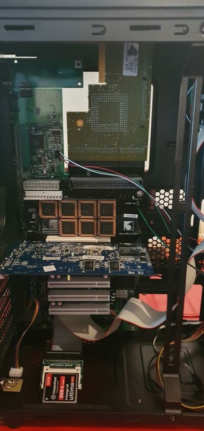

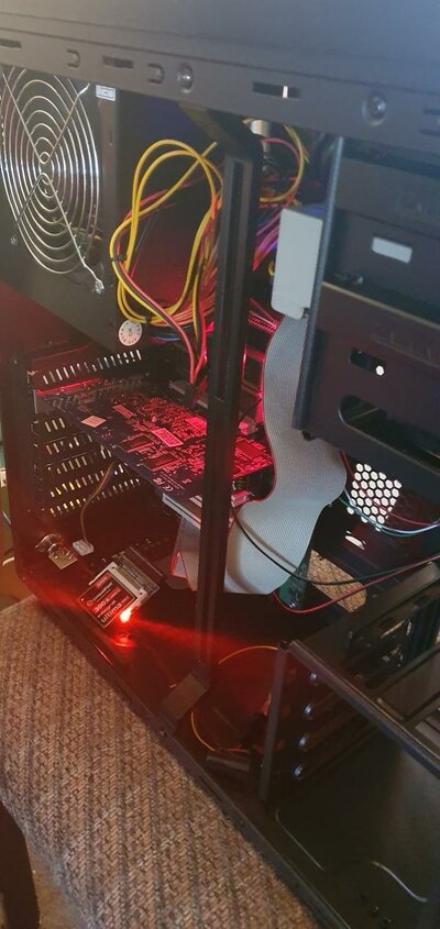

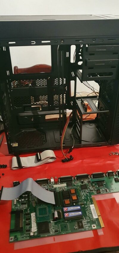

I recently bought Johnim's Blizzard 1260 and thought it deserved a little more than a Wedge A1200. Looking around for A1200 Towers used at first brought up the usual suspects such as the Elbox and EZ Z4 Towers however I found that Elbox now sell a brand new Tower, the Black Box 1200, I bought this along with a Mediator TX Black and a Radeon 9250.
Here's the Hardware that will be going in the Tower:
A1200 + Blizzard 1260 + FastATA
I have a few gripes with the build quality, it feels like a £50 tower and I'm sure that's what it would sell for if it wasn't adapted for an A1200, it does however come with all the bits you need such as keyboard adaptor, PSU and all connectors.
Fitting all inside was a bit tricky to get all lined up, I had to experiment quite a bit with the spacers to get a square fit with the PCI card in place furthermore I'm not 100% pleased with the pressure put on the Blizzard by the case, they didn't think that through (it's pushed over a tad - this would make fitting a GREX difficult.)
The other small issue is the PSU doesn't fit back in very well however it was all functional on first power on so they (or I) must have done something right!
Next up - Setting the software

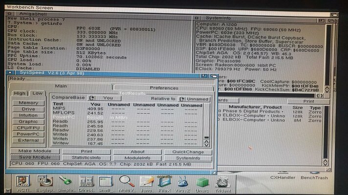

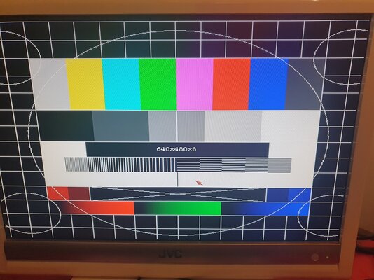

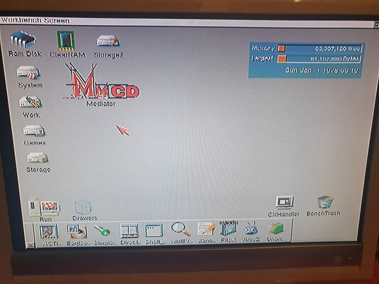

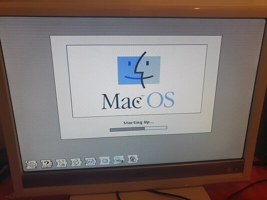

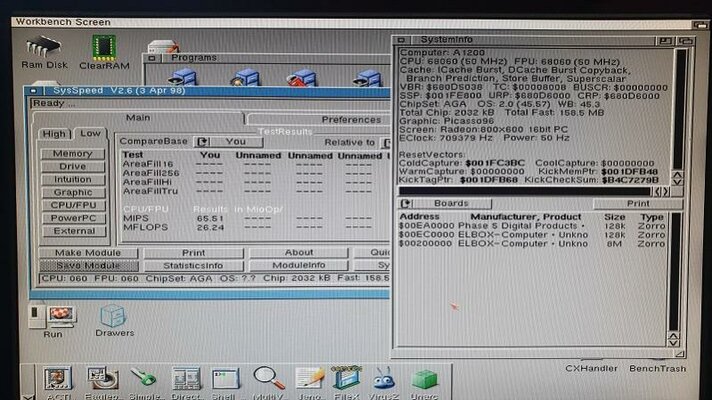

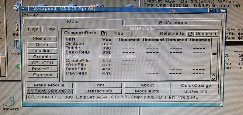

I was a bit lost at first as it's been a while since I setup an RTG Graphics Card, I had forgotten how back to front the Mediator drivers are, but after a bit of fiddling I was able to setup a basic 640x480 RTG screen:
20191214_130001.jpg20191214_131754.jpg20191214_140735.jpg20191214_141037.jpg20191214_141150.jpg20191214_142033.jpg20191214_142333.jpg20191214_142354.jpg
I was pleased to see the Radeon added some extra Fast Memory too, that's a nice touch. I just need to remember how to get the higher resolution modes working, I've got 800x600 32bit now so making progress...

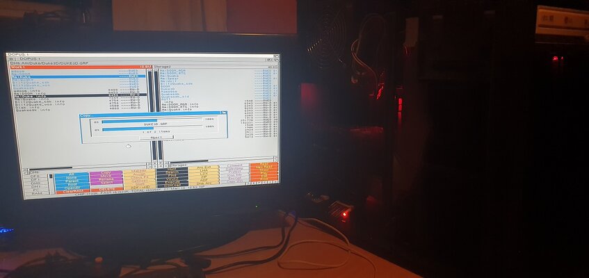

Cheers mate, got a nice 720p screen rocking now so looking good over here :)

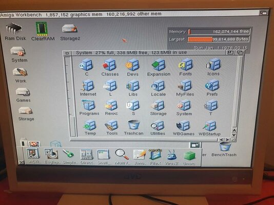

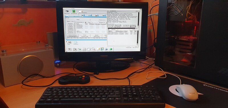

I setup the Tower in my spare room for some more tests today:
Getting Sound Card, Voodoo and Networking soon hopefully :thumbsup:

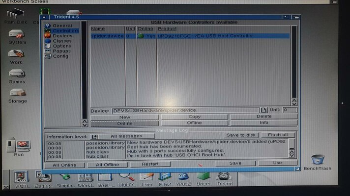

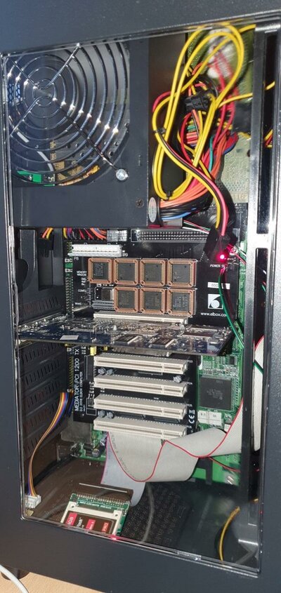

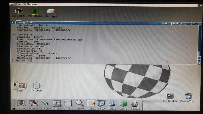

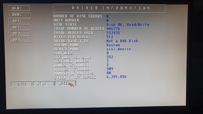

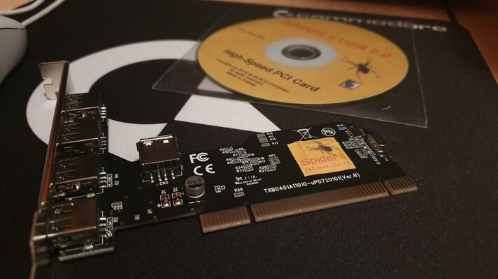

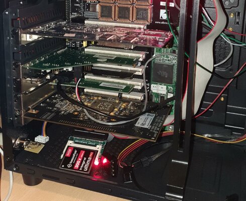

Some updates to this project, I have now installed Sound (FM801) Spider 2 USB and a Network Card, all setup and working now. Has taken me some time over Christmas to get everything how I want it and working but all working great, I have a Card reader mounted at the front hooked up to the internal USB port on the Spider with a small adapter I got from Amigakit. I managed to find a cable for the CD audio and confirmed working today all mixing with Paula & 16bit Audio, CD is hooked up to the internal AUX port and CD tracks were playing on T-Zer0 :D (After some fiddling around!)
Very pleased with this build overall. Would be nice to have a Sonnet PPC card or Warp3D on the Radeon. I do have a Voodoo 3 2000 here but I like the Radeon setup, I don't think I'll mess with it.
A few more pics, case closed for now:

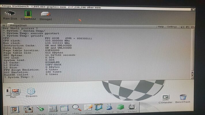

Cheers bud - I'll pop over and say Hi. It seems to be running fine even with sound through the FM801 the only issue I have is that I can't run the USB and PPC at the same time or it hard locks up, this means I have to run the PPC Innit from script when I want to use it and/or disable USB first.
Next job will be to install a Voodoo 3 and see if I can get Warp3D going...
