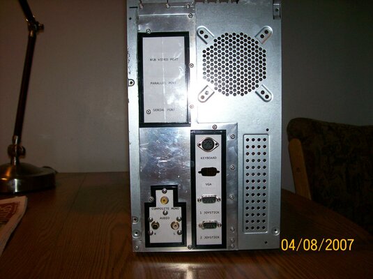

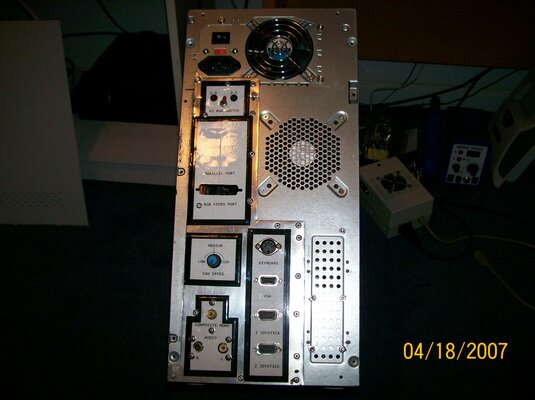

Looking good so far. I like the clean look to the rear ports

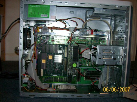

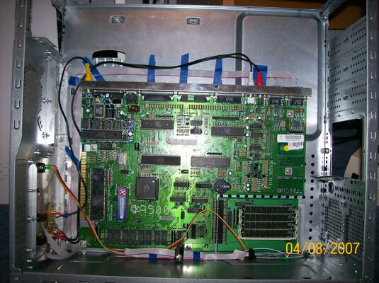

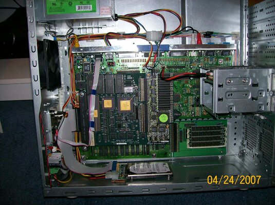

16GB is RAM should be quite enough for most stuff, for example preloading loading all WHDload games on the ramdisk.. Also, those pictures are quite old, or you forgot to set the clock. Yes, I tend to be pedantic.and then I'll have 16GB of fast ram
Well I am after a one of those 500sx 8 MB expansion (for the expansion port) , as it will fit in the ATX case (I left room for it) But I will have to remove it from it's original casing, and then I'll have 16GB of fast ram (The Accelerator is a CSA Mega Midget Racer with the 8MB RAM card). But so far no luck in finding one

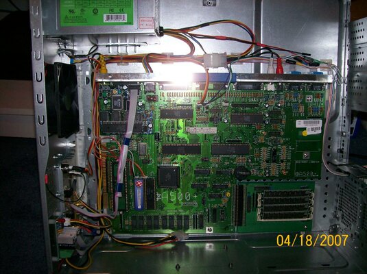

Oh, By the way. The ICD flicker fixer wouldn't fit, as the video hybrid was way too high, so I had to solder it under the 500+ board (horizontal)
16GB is RAM should be quite enough for most stuff, for example preloading loading all WHDload games on the ramdisk.. Also, those pictures are quite old, or you forgot to set the clock. Yes, I tend to be pedantic.and then I'll have 16GB of fast ram![]()
LOL, you should have soldered the video hybrid under the board instead![]()
What kind of HDD controller will you be using?
