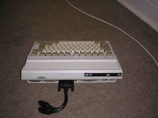

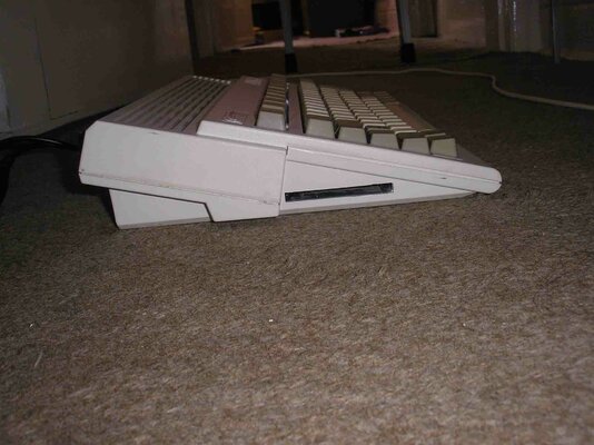

ok been doing a bit more iv put an dvd r/w in it but im waiting to get an male 44pin cf adapter so iv put an 2.5"hdd in for now.
its a but like an holiday suitcase to close it but it closes and works.
[attachment=1:5zstqpuj]P7190015.JPG[/attachment:5zstqpuj]
[attachment=0:5zstqpuj]P7190016.JPG[/attachment:5zstqpuj]
Re: a1200 in an a600 case
ok ran it for a long time running darksead cd32 it was 21.8/9 ?c outside ran for over 45 mins and it was a nice warm 35.2/3?c inside with cd rom working and 2.5" hdd running.
so not to bad
james

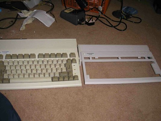

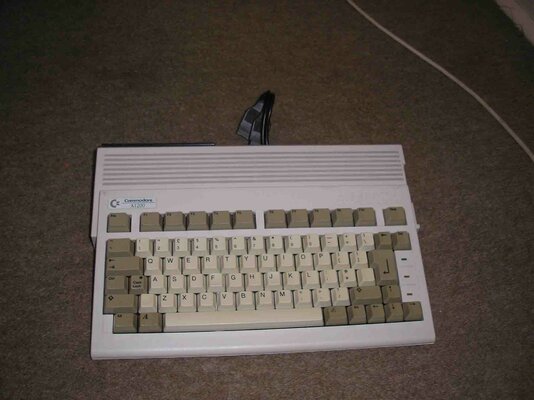

new case came today a lot more white than the fisrts on so the chopping began its all in the new case now no holes in the side of this one
[attachment=3:21nqd5c8]P7250004.JPG[/attachment:21nqd5c8]
all done
[attachment=2:21nqd5c8]P7250017.JPG[/attachment:21nqd5c8]
made the pcmcia slot a bit longer
[attachment=1:21nqd5c8]P7250019.JPG[/attachment:21nqd5c8]
the dvd rom
[attachment=0:21nqd5c8]P7250018.JPG[/attachment:21nqd5c8]

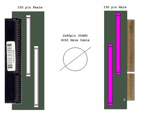

@James
I haven't forgotten you my friend, I have plans to build you a cabled Accelerator Extender, similar to the PCI extenders but with a A1200 female connector at one end and male connector at the other.
the length will be just under 10CM.
lets see if i can draw a pic quickly... (DONE)
now I can have the MALE connector fabricated by www.futurlec.com, I have done business with them before and there end product is fantastic. the FEMALE connector i can salvage from a dead card that i have here :)
now that look good whats the cost of the male end?? 102 pin is that? thats a lot of soldering but worth it in the end
thanks mate
james
ahhhh my mistake, (been reviewing the CD32 expansion bus recently)
The actual connector is 150 pins I shall adjust the pic :)
the Male connector will be around £20 to make i think from futurlec, including setup costs. it all comes down to getting time to build it in eagle PCB software and test it :D then comes the fun in building it :D
I will probably use two sets of High Density 80 pin SCSI Cables and connectors from each part, these give a great contact without to much resistence and or added latence in the cable.
please note that this is ALL theoretical and we wont know if it will work, until we have built it :)

heres the female 80 pin scsi connectors I was thinking of using on each component
Also review the attached re-worked file it should give you a rough idea :)
Cool plans. Is there going to be enough room left in the case to locate an accelerator though? Even with this connection extender?
Will you be building it so the extended connector is pointing in the other direction? So any attached card is pointing into the case with the edge connector towards the right hand side of the case?
I can't wait to find out if this will work. Will be so great if it does. And if so it will surely end up being one of the best Amiga builds to date.
What else could you add to this project? How about some clock port expansions? ;) :lol: Catweasel, scan doubler, usb ports, internal network adapter?
@zetr0
hi there nice plans but it wont fit under the floppy if we could put the scsi plug in line with the board so the cable plugs dont stick up it may go in. and we need the cable longer than 10cm. if im down your way i will have to pop in with it so you can see the inside and get a feal for how much room i have.
it be better to solder on each pin of the end coneter for lower profile
james
Wouldn't there be issues with data transfer if the cable was longer though? How about relocating the floppy drive to make room? Have it on the right? ;) Or replace the floppy with a Catweasel and a low profile high density laptop floppy drive. YOu wouldn't be able to boot from that though AFAIK.
Signal Loss and Signal Doplar
Signal Degradation
As we all know a signal is lost over its length, this Signal Loss over length can be negated by using either shorter length or signal amplification, the things one can do with an opamp :D, although this can (and often does) introduce further noise to the system.
Signal Doplar (cross and shadow/echo signals)
This can happen in a variety of ways, but the most common is one line picking up another line signal. the problem is by introducing long signal lengths you also increase instability of the signal. this is through the noise generated by other lines carrying thier own signal(s)
A practical way of this is to run both Large Ground Planes and interleave ground wires to further reduce noise (kinda how an ATA 100 cable works)
I always remember reading that quantum physics book in the local library how so many metals are impractical to use at very low temperatures (like -10c) as they become essentially a super conductor, this can decrease the signal travel time so significantly not only can your latching times be way off to collect the signal, but it can be reflected back up the signal line causing all sorts of nightmare.... imagine it like ripples in a pond reflecting and refracting off each other....
Anyway.... around 10CM with 30AWG or higher, (may need interleaved grounding wires) should be okay, but its an experimentation at best :D
