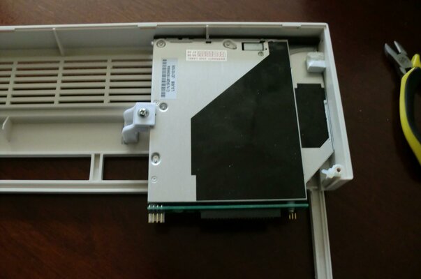

I bought a Mechware SCSI Card reader to replace my Floppy drive and Roy Bates kindly made up a custom SCSI cable for me:

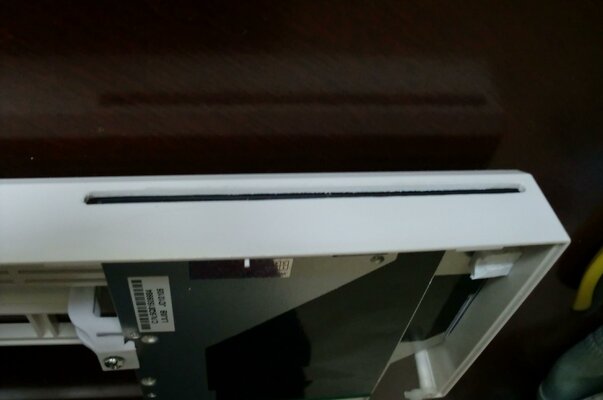

Installed into the original position of the Floppy Drive, to access the slots will need modification of the A1200 lid of course, this will be considered at length before any cuts are made, as my Father in Law says, measure twice, cut once!
