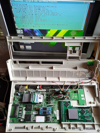

I cheated lol
I copied the system: from one card to the other.
Removed the ; in front of the driver line in the startup-sequence on the card for the 1200 IDE.
You also need to make sure the 1260 HD/CF has a higher boot priority than the IDE HD/CF
Fitted both cards and booted up the system.
The system resets itself once it's loaded the driver.
It then switches over to the higher priority on the 1260 IDE and continues booting from that HD/CF

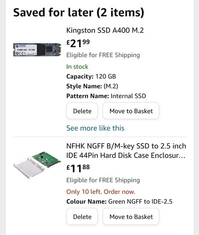

Nice idea, you could even just use an old 16mb CF lol and load the IDE driver and let it reboot. I'm thinking of ordering this for my main drive:
There's a thread on EAB discussing SSDs.
People have had various results with them in 1200s
http://eab.abime.net/showthread.php?t=108321
Cheers, I actually bought the above and also from eBay two msata-ide adapters and two 32gb msata drives as well so I'll have a few bits to test I'll let you know how I get on!

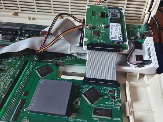

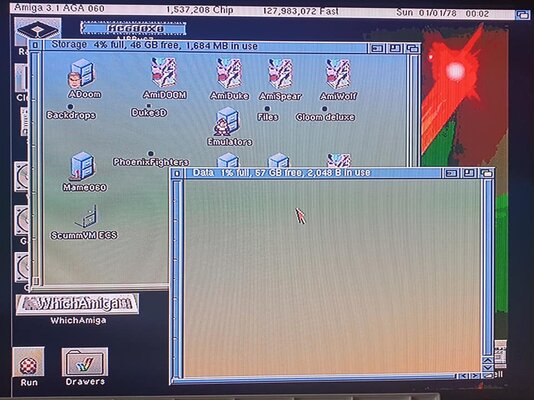

Tested the M2 SSD and adapter in my A1200 today off the TF 1260 IDE, works like a charm (well apart from sysinfo crashes if I try to do a speed test)
Need to get a longer IDE cable of course :cool:
