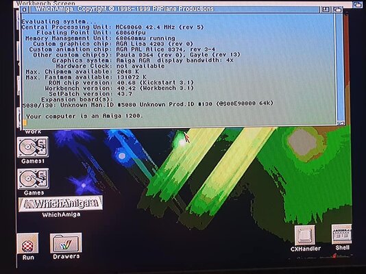

So I gave in and got a Rev5 060 =D
tested @ 63mhz
IDE @ 63mhz
Had a quick blast on Quake which ran well all stable :thumbsup:
Gets fairly warm mind you so could use some cooling above 50mhz...

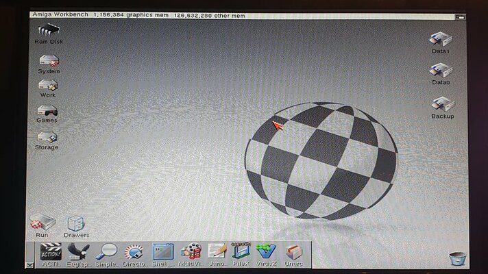

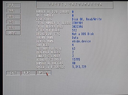

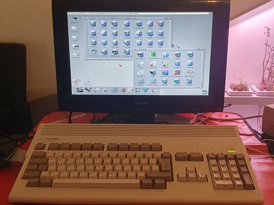

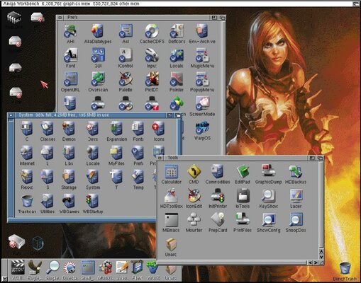

Small update; I finally setup my own OS, I went with my favourite CWB 3.9 and updated the Icons with Kens Icons. I was tearing my hair out for a while as it wouldn't boot, turns out the scsi.device of BB2 does not like the mini SSD adapter! Sadly these drives don't work on the TF IDE which is a shame (maybe in a future IDE driver?) But it boots fine on the Amiga IDE using 43.45 :)
In addition to the 32gb SSD I have an 8gb CF on the TF IDE for some extra storage and to enjoy the faster speeds loading up some of the bigger games, etc. Screenmode is 800x600 out of the Indivision AGA MkII. 64 colours

Quick question, how are you getting 800x600 out of the Indivision?
Cheers!
A.
Hi Andy, thanks for the kind words. I use the superplus driver for 800x600 note that it only works with the original firmware the indi was shipped with. It also works on the IndiECS if you have the Beta FW.
There's also HighGFX (1024x768) and HD720 but they use a lot of Chip Ram!
