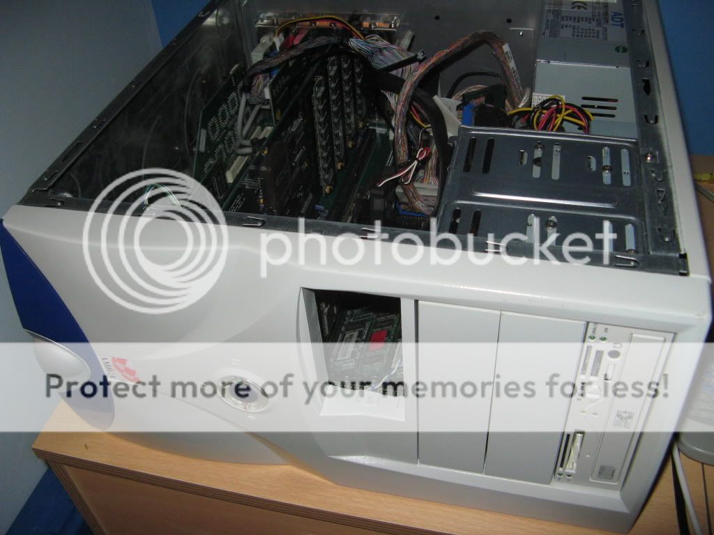

Little update!
I've installed my CyberVisionPPC, I had to borro the Deneb from my A4000T as the rommable modules I need for this setup are all in the Deneb :coffee:
Anyway, pleased to say she booted first time, no issues :thumbsup:
Time to find out if you can used PCI Sound/Network with the CVision...

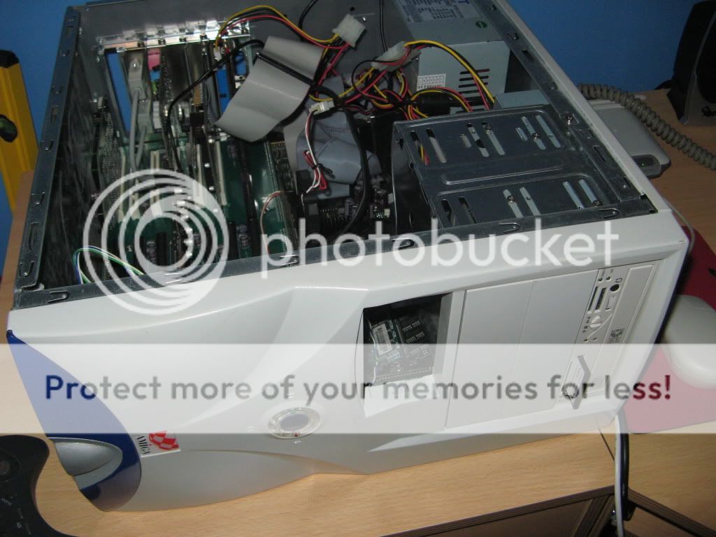

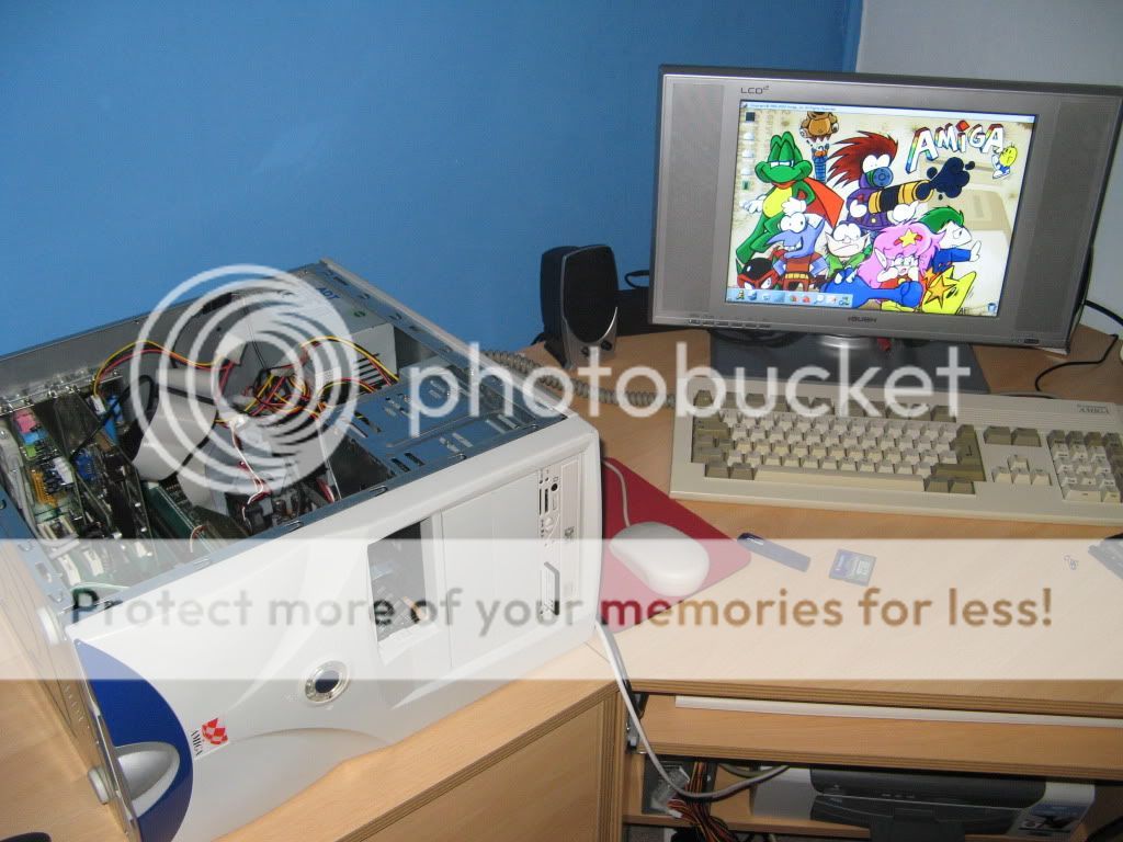

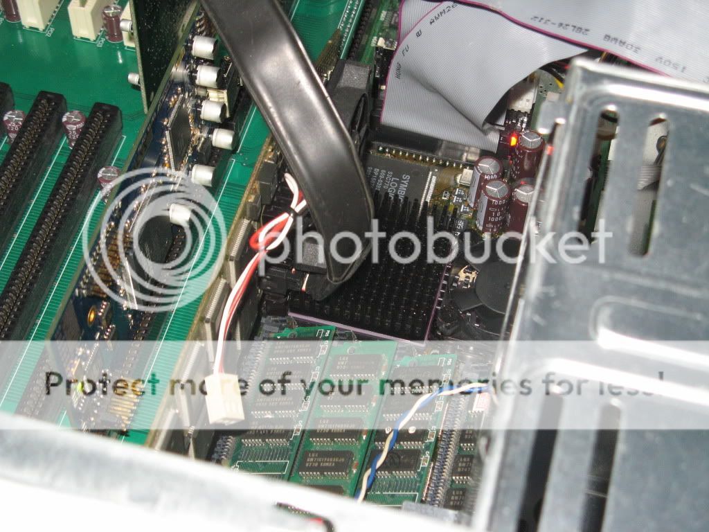

Got a small update for ya'll, I've mounted some bits in the case a bit better, the CF-IDE is mounted at the back now and I've installed ny CDRW with internal Card Reader.
Dual booting is all working perfect and it's all rebootless since I keep the BB2 modules in the Deneb :cool:
Cables are a bit messy, that needs a tidy up before I close the case :coffee:

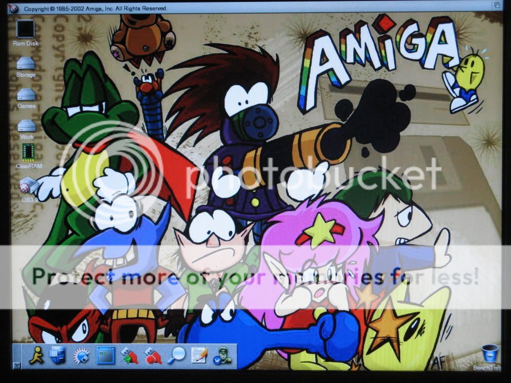

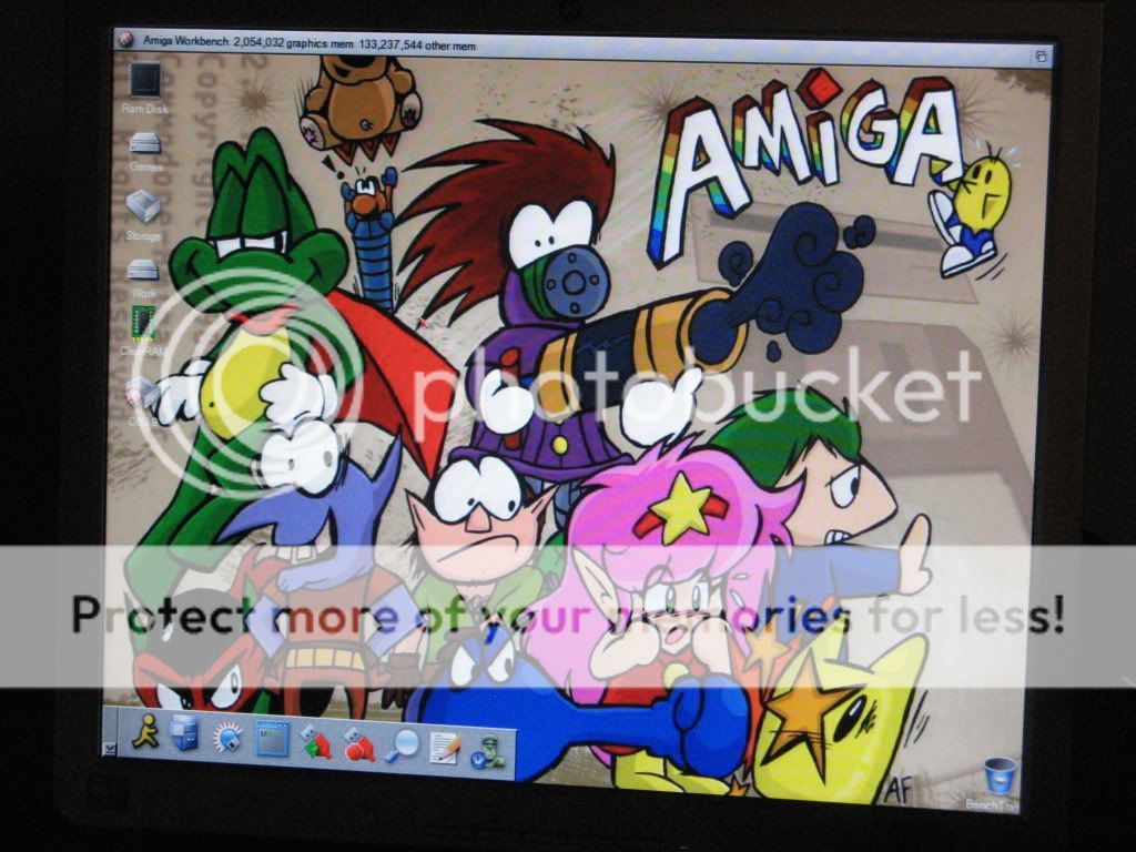

This is CWB3.9 with CGX4 & Kens Icons/AfA_OS running of the CyberVisionPPC, booting off the SCSI:
And if I plug the CF card in it boots up CWB3.9 with Picasso96 using the MediatorPCI/Voodoo 3 :ninja:
I'm using registerd 060 HSMath Libs and WarpDT which I also licenced, this machine runs like sh*t off a shovel :lol:

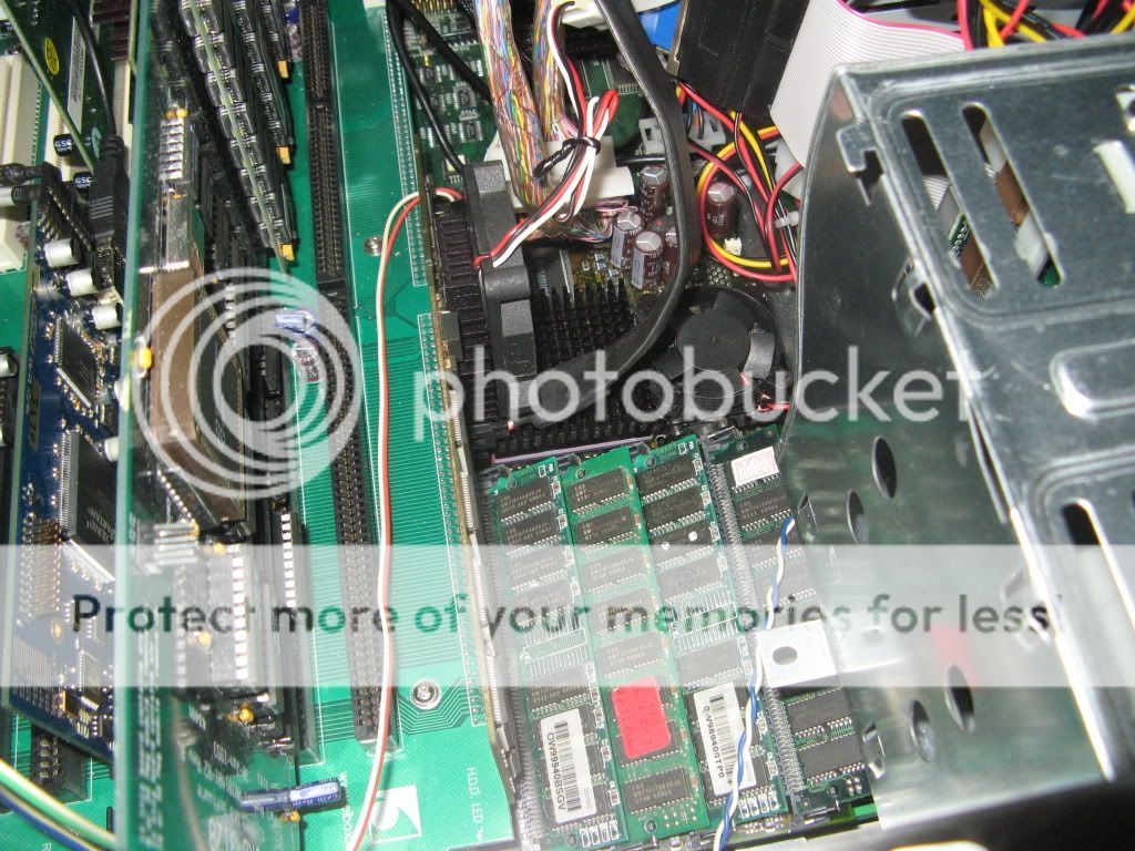

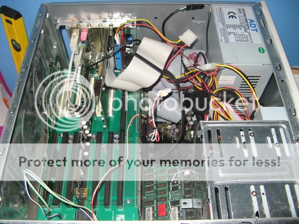

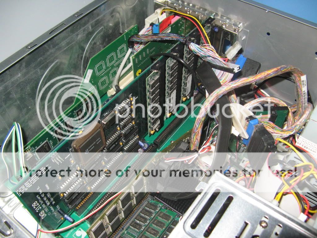

A few new pics taken today, I've swapped the ribbon cabled for something a little more up to date, need to re-route them when I have some more time.
Oh also added a DKB3128 & 128mb ZorRam lol, I know who needs almost 400mb Ram in a Classic Amiga :lol:
Still, fun though!
