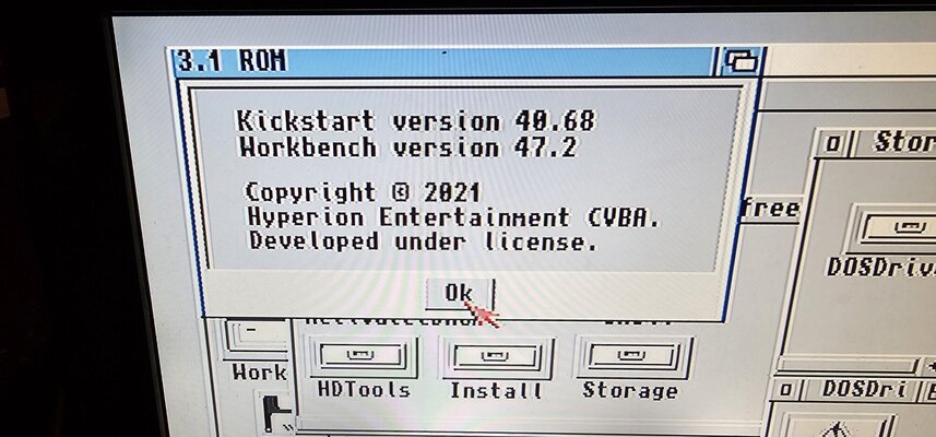

Workbench should tell you the kickstart rom number which will let you know what rom it is or even the amiga boot disk screen it should say 3.1 rom followed by 40.070 for the A4KT rom

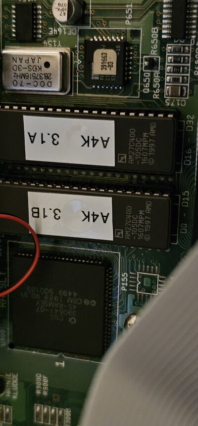

Why would someone do this? Are they original? They look like EEPROMS, AMD from 1997.

Yeah 40.68 is regular A4k Rom.
Is there a hole under the labels if so yeah EEPROMS. Get them flashed to 3.2 since you own the license
Ordered replacement 3.2 ROMs yesterday. At least I know I'm not losing my mind. Thanks for your advice mate.
They are eeproms so you could get them reflashed, will say the are marked as just A4K ROMs and not A4KT ROMs.
Now my brain is working overtime and I'm thinking maybe there's nothing wring with my 3.2.2 ROMs after all, and something wrong with the motherboard and that's why it doesn't have the proper 40.70 ROMs fitted.
Urgh.
