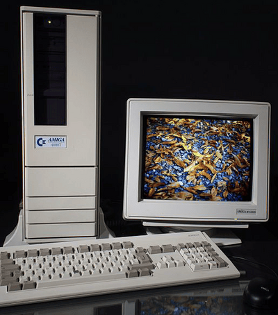

What are they connected to? I don't see any monitor or mouse / keyboard...
