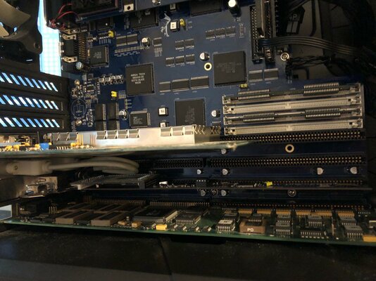

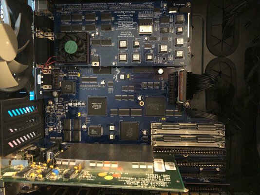

in follow a short update of my 4000tx. After searching I found blue A3660 pcb and build a complete card. So finally my device is nearly complete (incl. xsurf 100/USB) in blue color and only the scandoubler and the cybervision still in green..... but it´s okay.
Here few screens:
everything work fine and I never had any problems with this combination !!
Hese you made a great job !!
