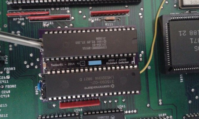

[TD]"Stand alone" plugged directly into the ROM socket of the Amiga. Price: 13.50€
Perfect for Amiga 2000 with or without Accelerator board plugged into the processor slot near the 68000.
Perfect also for Amiga 500 installed into a tower. Not usable into an A500 desktop

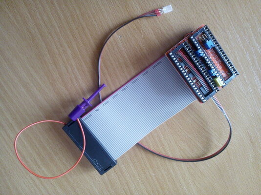

[TD]"Ribbon version". A little ribbon-PCB is plugged into the ROM socket of the Amiga. Price: 21€
The Kickstart Switcher is connected to the ribbon-PCB via a 40 wires ribbon.
Usable into AMIGA 500, 2000 & 600.
This version is usable also into an Amiga 600. My A600 doesn't run with the KS1.3. I don't know why.
So, onto my A600, I have tested the Switcher only with KS2.05 & KS3.1.

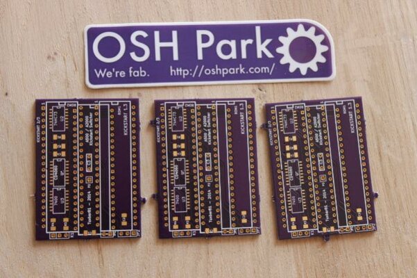

I use Oshpark.com to produce the PCBs. The first batch of only three PCBs costs me $19.15USD (around 14€).
The price for one PCB is $6.38 / 4.16€.
To reduce the cost, I need to have enough interested people to obtain a minimum surface of 150 inch² of PCB.
Like that, the price for one PCB is $3.83 /2.77€!
Assembled with components, I hope to be able to propose a price around $20 / 15€ maximum without shipping rates. (not expensive, very lightweight parcel).

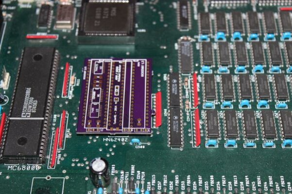

The three prototype PCBs are arrived today!:)
Two weeks to arrive... from USA to France... with a stopover Blegium.:mad:
You can see on the picture how it'll be placed onto the A2000 motherboard.

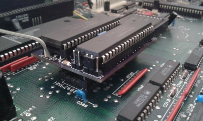

Kickstart switcher tested this afternoon. Runing fine.
The LED functionnality works fine also.
Test with KS2 & 1.3: OK
Test with KS3.1 & 1.3: OK
Video will come soon.
some pictures of the Kickstart Switcher onto my A2000.
Very cool, this will be a lot easier, no more stupid switches at the backside of an A500 or the 2000 :)

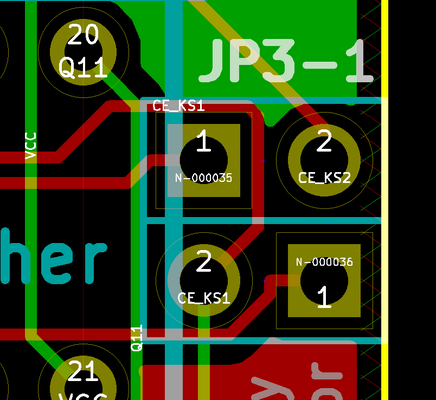

OK,the prototype works fine... but, I have made a little modification.
The final version will allow to select on which Kickstart your Amiga will boot by default.
There is now onto the PCB a square 4 pins connector (see the picture below).
If the two jumpers are set horizontally, the Rom into the first socket is used for the initial boot.
If the two jumpers are set vertically, the Rom into the second socket is used fot the initial boot.
  • Capture d'écran - 10062014 - 19:25:59.png
