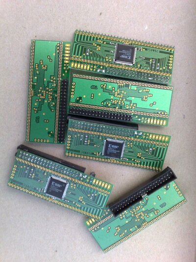

My V402 IDE68k just died,Black Screen :(
I was using it with Toms 8mb RAM Board and WHDLoad for an hour or two and had a GURU message, then i reset and now the board is dead and just checked my 2.05 ROM and that gives blue screen:(
The IDE68k Board has been in and out of CPU socket alot, and also the CPU mounted and extracted from the Board itself alot, my bad i think
I have PM'ed Mika asking to buy a new board:)
2 (not 5) tested v402 boards left.

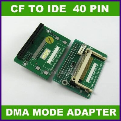

anyone know how to do the 5v hack to make the 40 pin IDE to CF get power? I ordered a 40 pin to CF adaptor from China and want to see about doing this mod.
The pic shows "vcc on pin 20" on the cf adapter so the +5v supply is connected allready. Some adapters need a jumper set for this.
