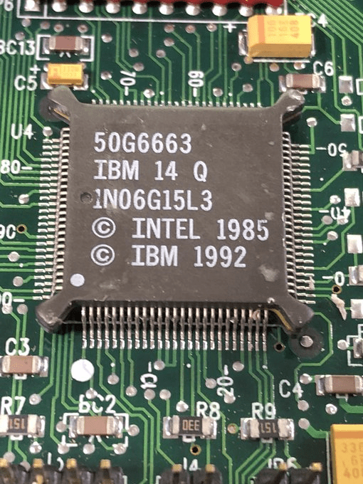

Here it is. I'm not really sure what to call it. Best thing to call it is probably the 486SLC/2 66. It runs at 66mhz, and has 16k split L1 cache.
Pardon the lack of goo gone, I've just taken off the heatsink to verify the chip.
For more info see bottom of:
http://www.redhill.net.au/c/c-4.html
Not sure if it’s the pic or not but if this doesn’t work...it looks like some of the pins are shorted?
That’s it on the original board still. You can get this visual effect when many pins fan out to the same signal in this case the 386sx and compatible chips have groups of three that fan out to ground and vcc.
There is also some sticky gunk from the heat sink I removed to verify the label that’s on the pins and board - I was too excited to clean it off first.
