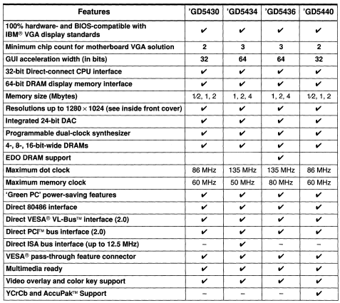

Edit: I tried to go one step faster with the Diamond Speedstar 64 by buying faster RAM. Here's a table from the tech ref (http://www.vgamuseum.info/index.php/cpu/item/download/1330_a6d67b2ab41f1663f52232a86798dc90):
Q8fKDGd.png]
As you can see, the 5436 adds EDO support but drops ISA support. The 5434 is still heckin fast.
My Speedstar 64 will have 70ns DRAM - it looks like I can't go any faster on the 5434 without EDO support (and at some point we're limited by ISA bus bandwidth, but I haven't done the math).

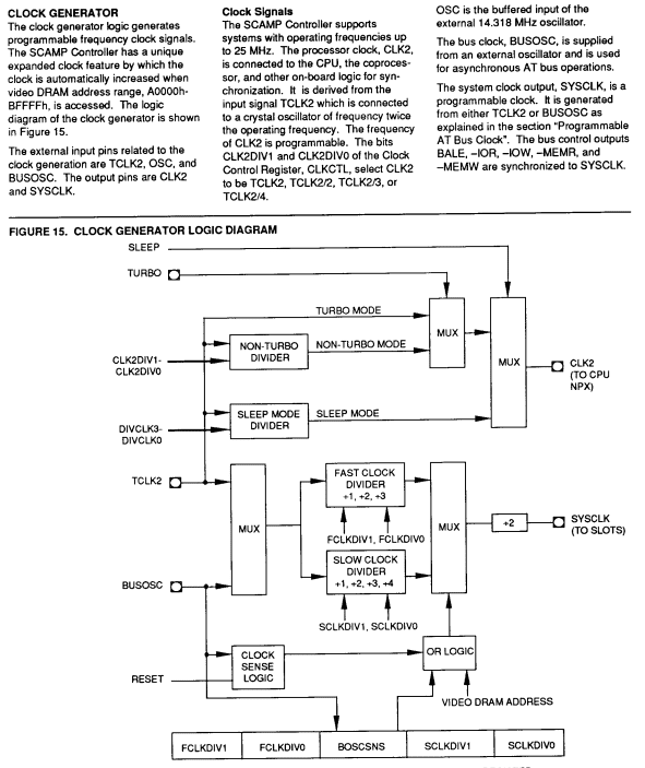

One more thing -specific to the A2386sx: some time ago I found a utility that reprograms the clock divider on the SCAMP (VLSI 82C311) controller to overclock the CPU - I can't find that utility anymore, but I thought the SCAMP controller documentation was really interesting. I've uploaded the datasheet to my dropbox: https://www.dropbox.com/s/55536rttki75d0b/VLSI82C311.pdf?dl=0
Of interest:
1) The SCAMP clock generator is documented as increasing the clock when video DRAM A0000-BFFFF is accessed.
2) The CPU clock is generated as /2 from that 32/40/50mhz oscillator on the board
3) Bus clock is generated from the 16mhz chip.
The divider for the CPU can be modified to attempt an overclock, or to simply have a 1:1 with the CPU clock oscillator and socket that. It looks like the bus clock can be modified as well. I wish I could find the Amiga utility that did the first part. But this looks like some simple register programming. So we could set a different base clock (higher or lower), set the CPU internal multiplier, maybe to get a slightly higher overclock. And modify the bus clock to get a little more bandwidth.
The interesting stuff starts at page 43.

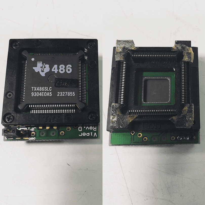

I'm on vacation out of town, so I haven't been able to use the upgrade board on my a2286at yet... Now have a VIPER Jet (Japan) on the way that is much like the Cyrix snap-on upgrade, just need to swap out the CPU on top for a socket.

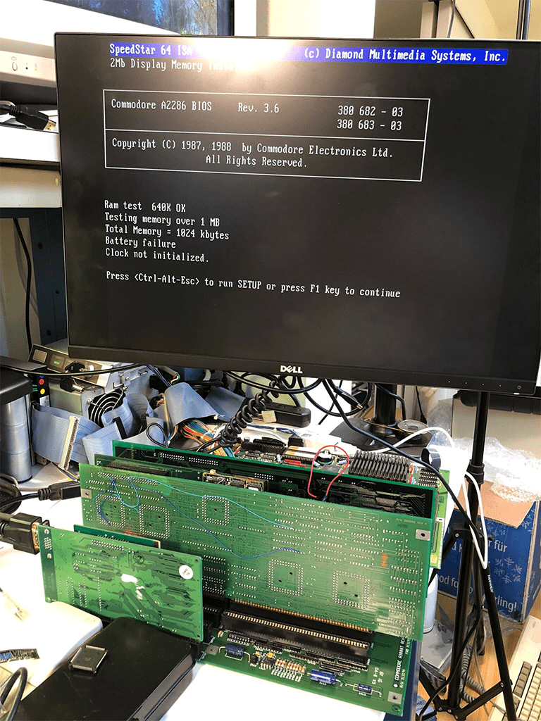

I’ll be interested to know if the Speedstar 64 works. Mine arrived yesterday (sold as working) and doesn’t appear to work with the GoldenGate. I get no startup beeps from the bridgeboard and just a black screen on the monitor. Can’t enter the gg setup program either. There are two closed jumpers on the board (7 and 8 ) which I haven’t tried opening yet as I haven’t had time so far. Going back to the ati Mach64 and all works ok.
i think one jumper handles zero wait states and the other irq’s, but references online do not seem to match what I’m seeing in my board.

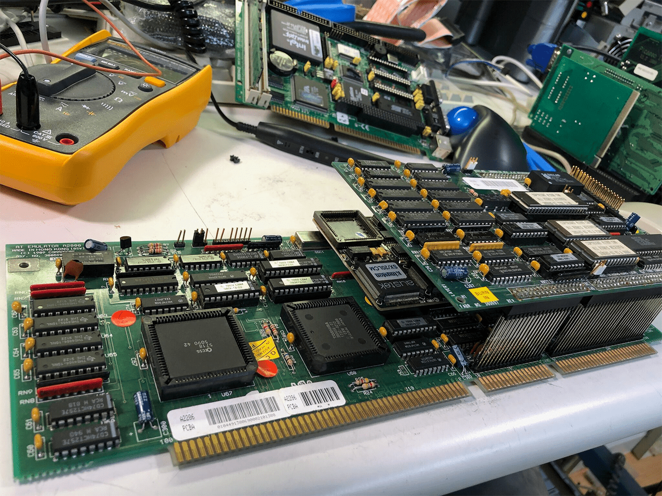

So I tested out the 286 bridgeboard I got, works fine. Jammed the kingston CPU upgrade into the 286 socket, between the board and the daughterboard (carefully), worked fine.
So now I'm adding a riser - I need to add bypass caps still, but this allows the upgrade to fit, the daughterboard to expand into the zorro-only side of the board, and allows using zorro cards behind both "expanded" slots as there's space.

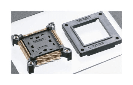

The upgrade board is a 386-20 - I'll be socketing the onboard clock and adding a Yaimachi IC149-100-028-B5 to socket the upgrade CPU.
Here's what the socket looks like (on order, will take a month or so apparently):

I've somehow broken the a2286AT by adding these headers. I cut them down thinking it was noise, to a level that would just fit the upgrade, but no dice, even with the old CPU. Still debugging :(
Issue was that my removal of the upper connector delaminates the board so I’m having to run some jumper wires. Had I thought of it at the time I would have ordered female idc headers with extra long legs, not removed the existing male headers for new ones!!!
Note to self: these are antiques!
Edit: board fixed and upgrade card works (but the upgrade card is currently a 386sx/20)

I should also mention - I'm not booting my Amiga to workbench - I have all disks disconnected and am using the test pins on the card (shorting 5v to pwrgood on the test header) to take the bridgeboard out of reset.
On video card stability - with this 286 board, the Speedstar 64 sometimes hangs at boot, as does my Mach64, as does all of the cirrus logic boards in general, that I have. I started looking into this:
http://www.os2museum.com/wp/the-isa-osc-mystery/
I measured the clock speed on my bus as 6mhz, then 8mhz after a bit, vs the 14.318mhz crystal on the board. If you have a scope you might try measuring as well. I have a 14.3181mhz oscillator on my bridgeboard, so I will replace the bumpers (capacitors) near the oscillator, and remeasure at the oscillator. I suspect the chipset ultimately controls the bus speed (as does the a2386sx).
I replaced the bus crystal and bumpers/resistors on my board (which had a bus and dma output, of which I had already selected to use the bus clock) with a 14.318mhz oscillator and now get bang on 14.318mhz shortly after the bus comes up. It first starts at 8mhz, and then switches over, and I suspect that's based off the oscillator for the 286 / 2. My a2386sx doesn't have this problem. When it powers up, the bus immediately gets the right speed. Maybe it's the change in speed on the bus?
More interesting stuff - the Diamond Speedstar64 has a pin on the fingers for the bus clock, but not osc (14.318mhz). I ended up getting it to work rock solid by disabling 0 waitstate, even though 0ws on my et4000w32i works fine.

VIPER-JET 386SX to 486SLC upgrade from Japan. Snaps on top of the 386sx. Jumper switches between the onboard CPU and the upgrade.
