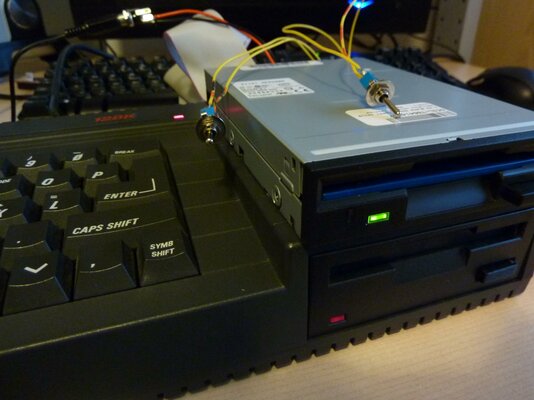

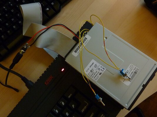

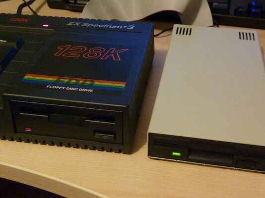

Its Alive!
Learning to solder was not as straight forward as I had first thought, although fairly pleased with the results...
Just needs a quick pant job and it will be perfect :D

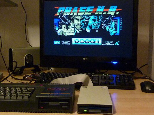

Using the switches I can select the external drive as drive A (the internal drive is then ignored), this boots disks written using Samdisk on your PC. The second switch can be used to select the disk side (1 or 2 / head 0 or 1) again Samdisk can be used to write to both sides (use the --flip command for side 2). This works really well for games that use both sides of a disk, when the change side message is displayed all you need to do is flick a switch. Also works well for single sided games as you can have a different game on each side.
