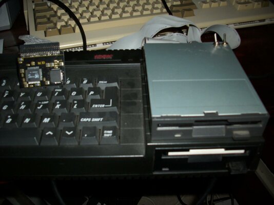

My minimalist version/emperors new clothes version
HI Heres my emperors new clothes version , usual switches on the back for disk side or drive a/b . Next attempt will be in a nice case when I can find one :thumbsup:
Thanks Chinners it works a treat :thumbsup:
ps the dangling sd card reader is attached to Zetros 8bit ide adaptor which also works a treat :-)
