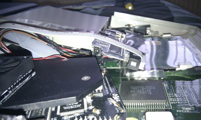

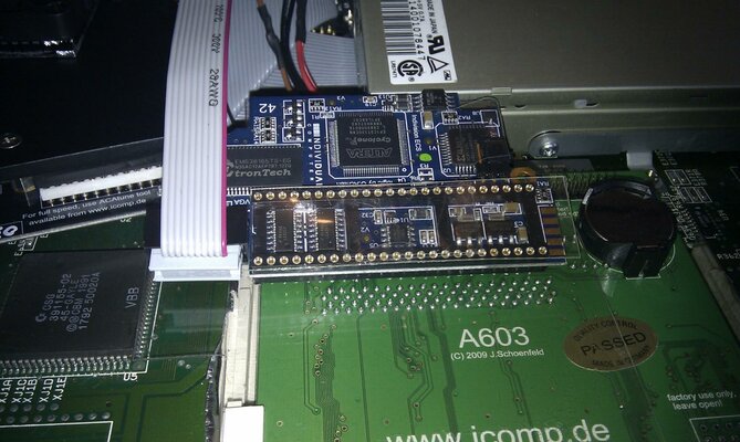

I added a 603 RAM expansion and an Indivision ECS to my ACA630 setup. Because removing the diskdrive wasn't an option for me I did some modifying.
