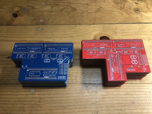

- We're testing the final candidate boards. They work but we need to make sure our installation instructions are clear, correct, and concise.
- It is a single-board solution (not two as previously mentioned), but there will be both a 250407 and a 250425/250466 version of the board. This accommodates the different location of the jumpers, crystals, and VIC-II sockets between the two motherboards.
- Doesn't fit in a 64c-style case at this time. Sorry. Not a lot of head room, so breadbin cases only for now.
- Doesn't require a case mod. The switch can be trailed out the RF channel switch hole without interrupting it's function.
- Only switches modes AFTER power is turned off, and you can keep it in whichever "default" mode you want. BUT, you must power off. A soft reset won't do it (latching relays).

Why 64c-style cases didn't work for this...
By the way, below is a picture of the versions we tested for use on 250407 and 250425/250466 motherboards in the 64c-style cases. Space-wise, they fit GREAT, even with heat sinks!
BUT
The main problem (as Akira and others mentioned) was that the analog signal paths from the VIC-II socket headers to the two VIC-II chips was too long... I couldn't get color signal to work at that length. So we went back to our basic rectangular layout, which had the shortest possible signal paths between the headers and the chips (through the relays).

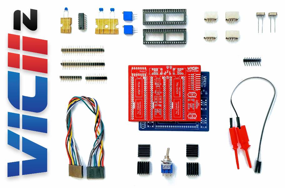

Hi everyone, we are delighted to say that the VIC-II² PAL/NTSC Switcher for breadbin C64s is now available! :arms
Please see the first post for the details. If you pre-registered your interest here, I've already sent you a message.
Thank you for all your support received through this wonderful forum. :yourock:
Now let's bring VIC-II the future!....
P.S. If you have any support queries, feel free to post them below!
