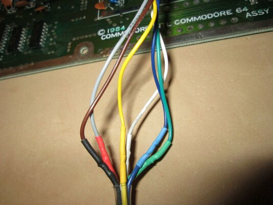

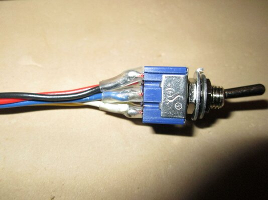

Experienced EE here, been working on computer hardware since 1982. Got the kit and assembled for a 425 board, no video can to desolder ;) Initially had Lumafix issues but turning both trimpots CC all the way made it better but not as good (random character shading color issues as seen in the pic on Ebay) as without Lumafix so will have to remove those bits. The issue I'm having is the relays are chattering like crazy and don't stop until power is turned on, they sound like a bunch of tiny buzz saws. Double checked all wiring and all is bit for bit correct according to the pics in the assembly instructions.
Could the pic of the switch be turned 90 degrees? According to the video it only is supposed to click over once and latch, mine are oscillating non stop when power is applied with the c64 power switch off.
Hmm that is strange. Sorry to hear of the problem. Could you please share photos of your entire switch cable assembly, connected at both ends as it is when the issue occurs?

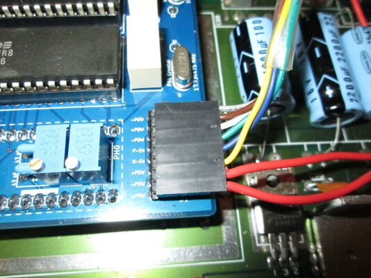

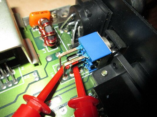

Take the DPDT switch out of the mix and ONLY use the hook clips (attached to the indicated leads on the C64 switch). Attach them to the P-En and N-En pins (middle two) on the 8-pin. It should latch and NOT oscillate. It will be EITHER on PAL or NTSC, depending on which lead you have on which pin. Now, switch the position of the two pins and it should latch to the OTHER setting.
If you're still getting oscillation in this direct-connection set-up, you've soldered something incorrectly.
If not, it's a bad wiring of the DPDT switch. Check your work and try again.
Reflowed all solder connections, checked everything 3 more times, still oscillates when connected to just the 2 middle pins. I KNOW it's not my soldering technique. I've followed the instructions to a T. Not rocket science for me.
Without a schematic I would say it's one or more bad relays or a bad board, care to share a schematic for the blue board ? Would be a hell of alot easier to troubleshoot if I had a schematic.
I know this is a no-support project but I purchased it from EBay so .... you know...
Definitely happy to help you out here. One step at a time... Please see above [emoji115]

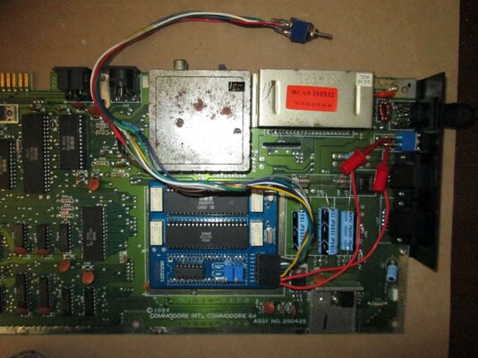

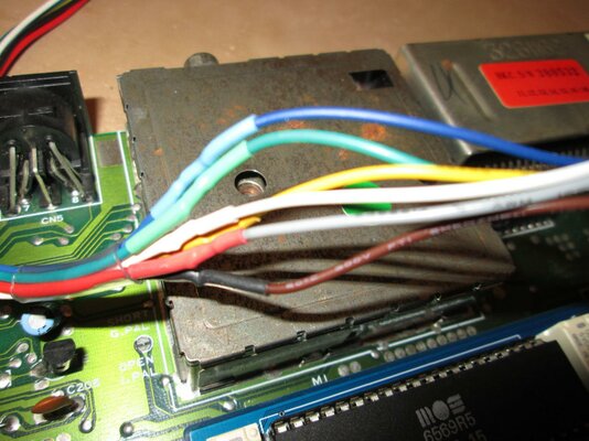

OK, here's a pic. Relays still oscillating when power applied to C64 power port when power switch is off.
I replaced your clips with mine and extended the cables to the DPDT to reach an existing mounting hole on left of breadbin case.
to reach tot h

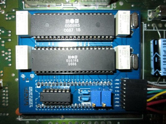

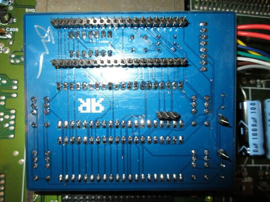

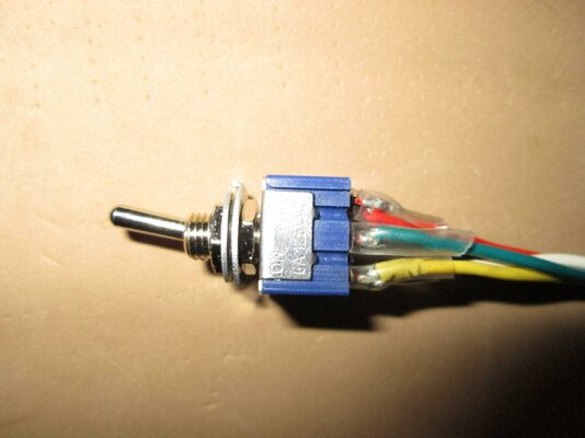

Thanks. That's a very blurry pic. Please show an in focus close up of:
1. The power switch
2. The Dupont plug on the VIC-II²
3. The switch wiring
4. Close up of both sides of the board
Using the flash might help. That way we can see what you see but with our knowledge of the product to determine what might be going on.
Thank you.
Flash did fire, see the RF can and between the VICs for reflection. I had to lower the resolution quite a bit so Amibay wouldn't error on upload.
I don't want to seem unforgiving but I have been repairing and modifying computers since 1982 and know what I'm doing.
Whats the firing voltage spec on the relays you are using ?
