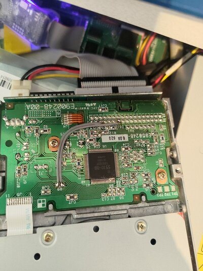

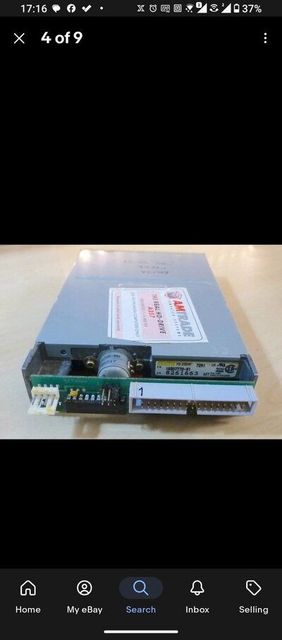

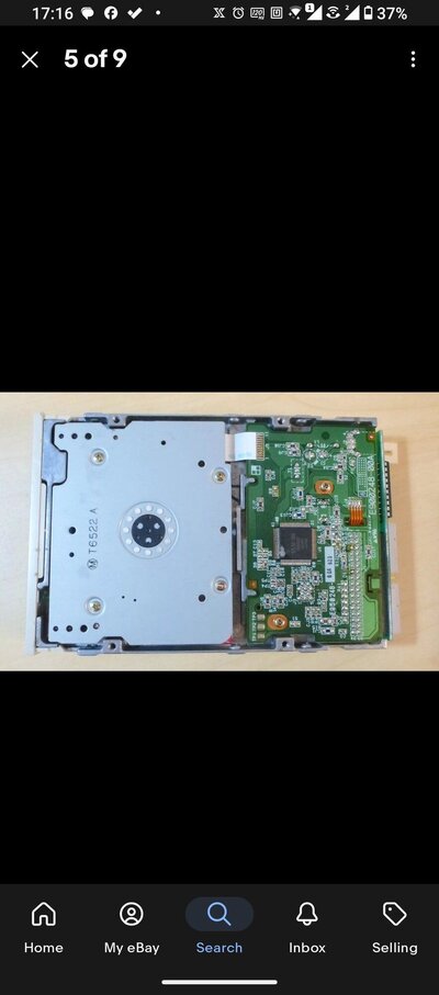

Glad I took a chance on a AMTRADE "Real" HD floppy drive 💾 on eBay.
When it arrived the drive was not working i.e not spinning.
On inspection i noticed resistor R9 was missing, but upon checking the BBOAH website I discovered that two wires had been removed off the drive which connected to the floppy header and the two points at R9.
I soldered them back on and the drive came to life but it still had read issues..
Well after half an hour using AmigaTestKit's head calibration, drive now reads perfectly with both DD & HD disks 😎
here is some pictures including the eBay auction pictures showing the drive before I put the wires on.
the circuitry of the adapter PCB doesn't seem that complicated surprised its not been reproduced
BBOAH mentions a sony drive version I wonder what the difference is and if it need a mod done to it like this TEAC version.

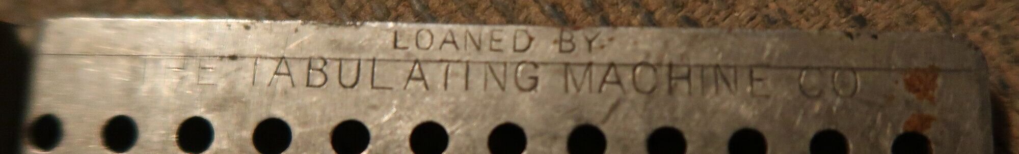

This is really pre-computer I suppose but still thought I'd share it here as I find it cool to now own something pre-IBM from 1933 or earlier.
Not sure what it was used for but you could obviously borrow it from the The Tabulating Machine Company (and someone didn't return it.... :P )
