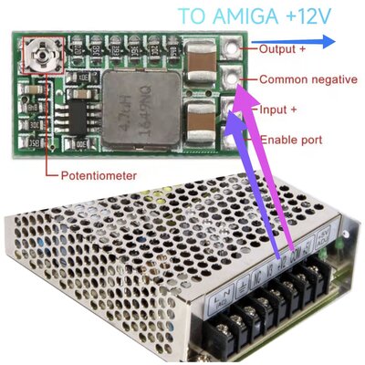

The one that 8bitdreams suggested has many options for the output.
Google "12v fixed output buck converter" and you will find for about 2€ in Italy. Just read carefully the specs before you buy it.
First link is the same one by 8 Bit Dreams, but sold via Amazon in batch of 10.
Correct. I didn't see the back side plus I was a bit confused by the description.
You solder the 12v pads and you connect your 12.7v to the in and gnd.
The output goes to v+ and gnd.
Just confirm with 8bitdreams that "en" means enable and it is connected to in+, so it makes the board always on.

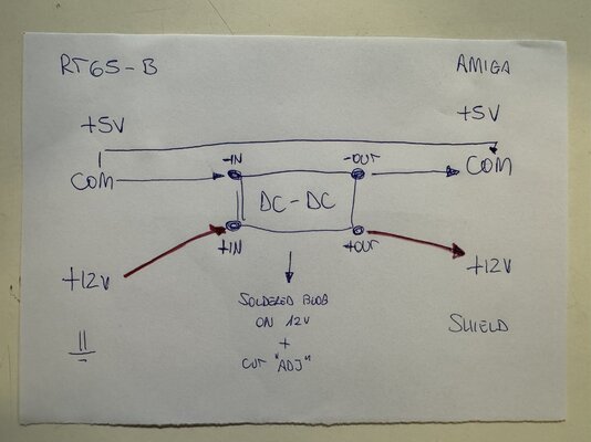

I had my DC-DC converter soldered.
01. Blob on 12V + cut where ADJ is.
02. IN+ soldered and connected to the MeanWell on 5V.
03. GND soldered and connected to COM
04. V0+ soldered and connected to +12V rail on Amiga.
Still not working. Meanwell must be set at 5.7 to switch A1200 + Terrible Fire on.
Yes that's the first step You need to do, and You've done it correctly
NOPE! NEIN! NICHT! 😱
You can't get 12v out of the 5V!
You need to connect 12v of the MeanWell PSU to the input:
Yes! Check! ✅
Nope! You really need two wires from MeanWell: +12V and GND!
Output of the DC converter goes to Amiga
Depends on that where this measurement was done - this power cable that goes to Amiga has reasonable resistance, so please do Your measurement on the TF1260 card itself, or Floppy power connector should have nice 4.95 4.99V and 11.7V or near on 12 V rail...

Hello,
Please excuse my ignorance - had a bad time in a past three weeks, real life has eaten all my spare time.. 🤕
Don't worry. Hope it's ok now for you.
NOPE! NEIN! NICHT!
Sorry. My mistake.
IN+ was connected to MeanWell "V2" rail. That's the +12V.
So +12V and GND must be connected to +12V?
Measurement was done on the floppy power connector.
If i set MeanWell at 5.70, floppy will get 4.90 something.
I will modify my cable and test it again.
GRAZIE - DANKE - THANKS.
No! Don't do this! If You do so - Your DC - DC converter will possibly burn!!!
Please see the picture above in my previous message!

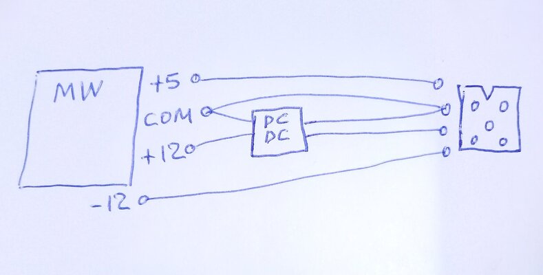

This is my schematics
5V to 5V amiga
2 cables from COM: one straight to Amiga, one on the dc-dc
12V from dc-dc to Amiga.
On the back, soldered a blob on 12V and cut ADJ.
