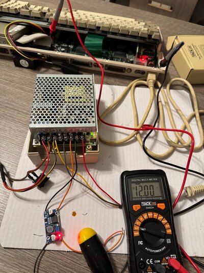

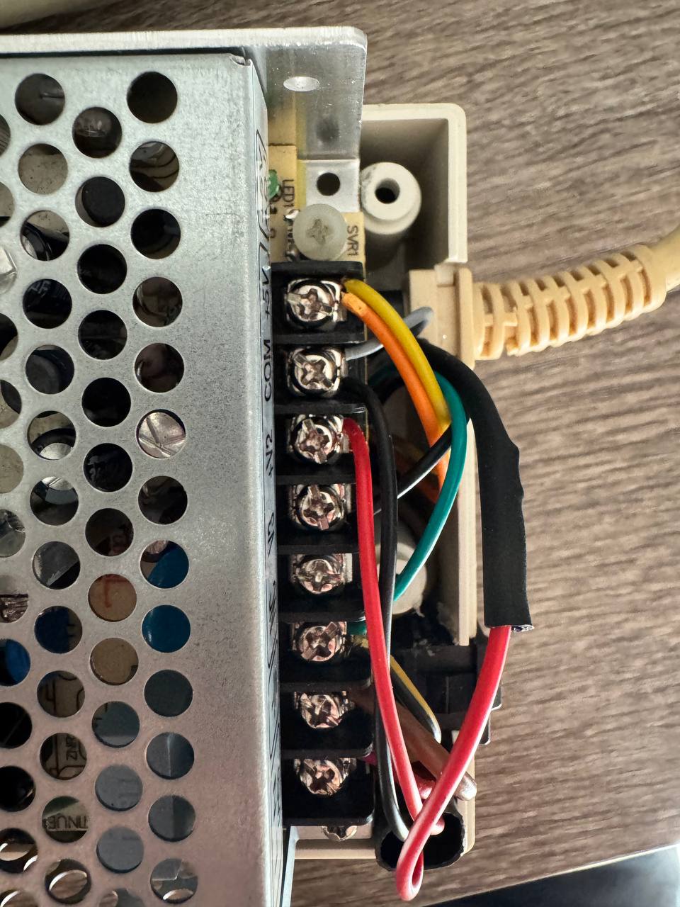

Habemus +12V and +5V with this DC-DC converter.
It’s bigger than the previous one but easier to solder. Potentiometer is tricky too because I had to screw it lots of times.
But once I noticed voltage was lowering, I stopped it at plain 12V.
So now I have plain +5 and plain +12.
Thanks everyone for your patience.

Unfortunately there is only one adjustment knob, so turning up +5V rail will also push +12V rail up.

If you want to get plain 5V on the FDD, you need to raise the knob up to 5.20 depending on the cables, especially if you have extended them.
Get a DC-DC converter: it will give you a plain stable 12V.
If you're into soldering, use this.
It's tiny and you can wrap it in heat shrink.
If you're NOT into soldering, but you want to learn, or make something useful, you can consider this one.
But it's bigger and a little bit tricky to configuire because you have to turn the screw until you get the 12V.

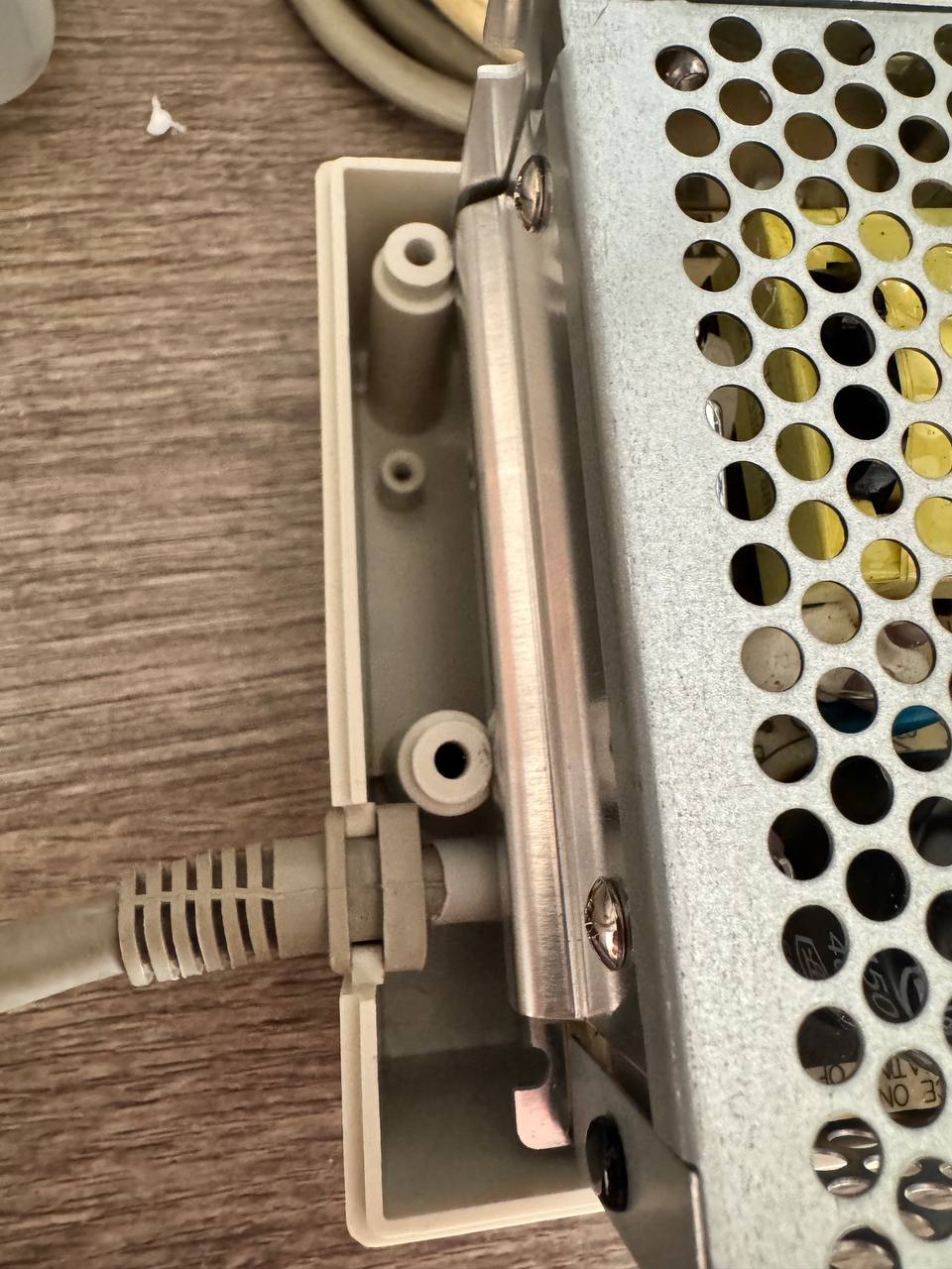

What A500 PSU case did you use, did you have to cut it?
Sorry for my late reply.
Didn’t need to cut it.
@Timtheloon you can see some pics here.
As I said before, I didn't cut anything. I just made MeanWell sit on the white things that cover the screws [sorry, I don't know the english name for that].
It fits perfectly, and once every cable is fitted, you can close the enclosure PERFECTLY.

I did a quick'n'dirty then squirted hot glue down the sides to keep the meanwell in place. I didn't test the 12v line after trimming the 5v with the built-in trimpot. I didn't even consider it until this post and another one on the topic! Nevertheless, I have some small voltage regulators in the post to fix any issues.

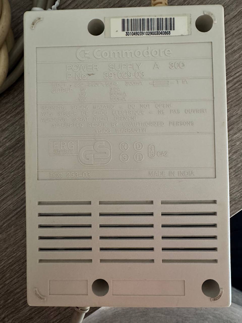

@fpmpaolo so its a very tight fit then.
@WhereIsTheParadroid your PSU case looks different from Mine & @fpmpaolo, the screw holes are not in the same position was yours originally the light weight C= PSU I noticed there are different types when checking on eBay.
Anyway I might have a option from @scrappysphinx so I might be all good

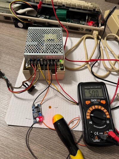

I'd like to ask a dumb question. Did you test the volts with the amiga plugged in because the meanwell needs a load to function so you had to plug it in? Or did you do it that way to test end-to-end power delivery?
If it is not the first time that you use the MW, yes you test the volts on the Amiga side.
You want the correct voltage to be on the Amiga, not on the MW.
@WhereIsTheParadroid as you can see here for the 5V and here for the 12V, voltages are measured on the Amiga FDD connector.
You'll see the black tip is in the shield while the red one is on the FDD pins inside my A1200: that's why @darefail said you need to correct V on the Amiga.
MeanWell has this potentiometer that raise or lowers the 12V when you raise or lower the 5V.
The DC-DC things keeps the 12V stable when you raise or lower the 5V.
