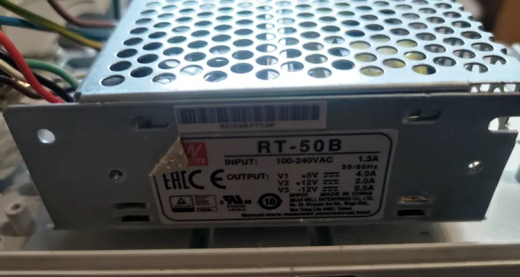

This whole time, I thought I had the 52b because I've covered up the stickers but no, it's a 50b. A diferent beast so no wonder I'm getting different values. Also, my A600 has been working A-OK with just a floppy and external go-tek.

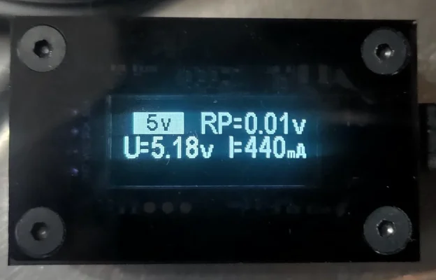

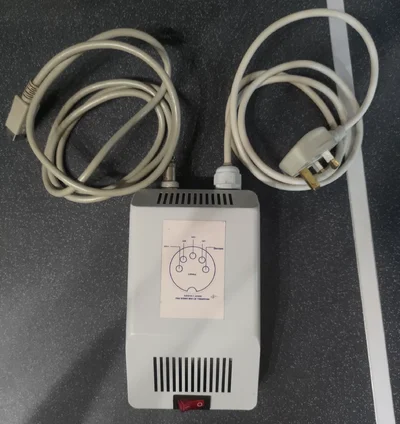

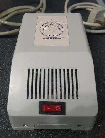

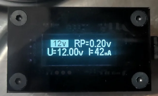

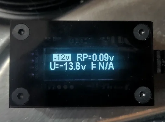

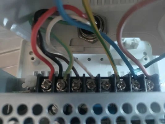

@scrappysphinx came through for me and sent me the Meanwell but its not a RT-65B but a RT-50B I used the Amiga PSU tester and the voltages seem good apart from the -12 seems high
Anyway here are some pics including the voltages
PSU
PSU internal sorry not the best pics
5v rail reading
12V Rail
-12v Rail
Not sure about my new middle Name @scrappysphinx 😆
So am I safe or do I need to do some tweaking
5v rail reading
12V Rail
-12v Rail
Those values are read from the connector.
I got them on the floppy inside the MB.
So on the connector you get 5.18V, but in the mainboard you'll get maybe 5.10.
You have plain 12V on the connector: they'll maybe be 11.90V on the floppy pins.
Anyway I think it's a very good setup for a semi-expanded Amiga.

-12v is needed for the serial port and you won't have a problem if it is -13.8v.
I believe I have some adjustment here if need but yes good idea to test what I get at the floppy power port
