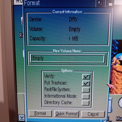

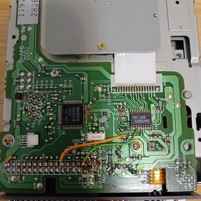

First try with Sony drive and... It is working 😁
It is a very quick modification and it needs a proper job.

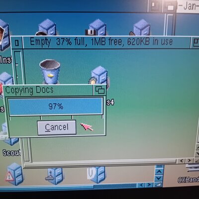

My first try was a WorkBench FFS format with no luck.. Initializing error.
Then I tried through X-copy, ffs format with an error at the last track. The disk was df0:unreadable.
Then tried again WorkBench format but this time no ffs format. Succeeded.
I threw in a file and when I reinserted the disk it could read it.

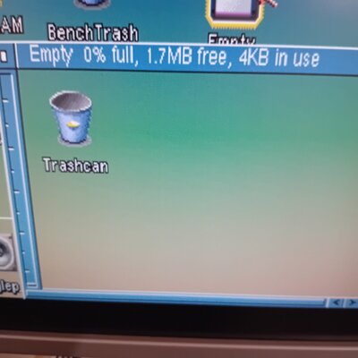

Then tried again with a ffs format, this time with success.
FFS format = 1.76MB
No FFS format shows 1.6MB
Anybody knows the difference?
What is your SONY model? Mine MPF920-E E/131 do not work.
The same. Even though according to other similar projects, the drive has to be made between 1997-2003 or have the same 2 chips, it is mentioned that 3 out of 4 drives are working.
Did you cut the trace where it is shown to separate the track?
On the left it is the drive that is working for sure.
The others will be tested with another HD project.
I did. I believe I have one other Sony I will try my luck again.
Difference between OFS/FFS on floppy is normal. Even on DD you get some capacity gain with FFS.
