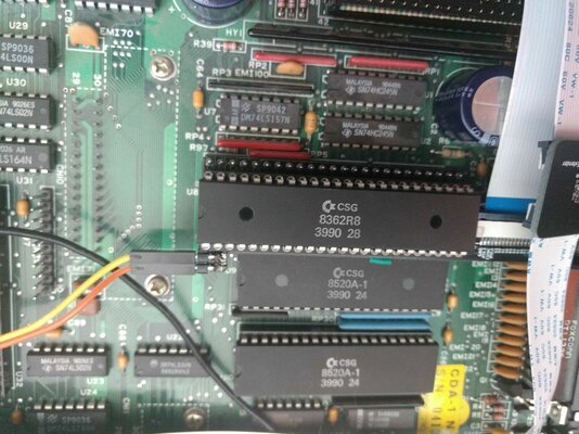

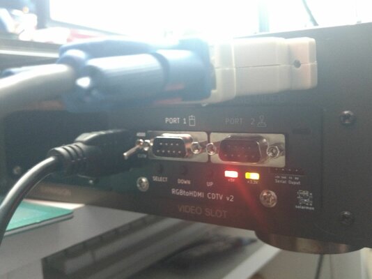

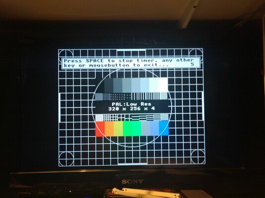

@Jameson , I'm hoping to get my CDTV setup with a RGB2HDMI this weekend if nothing else comes up and I get it up and running I can do some testing for you.

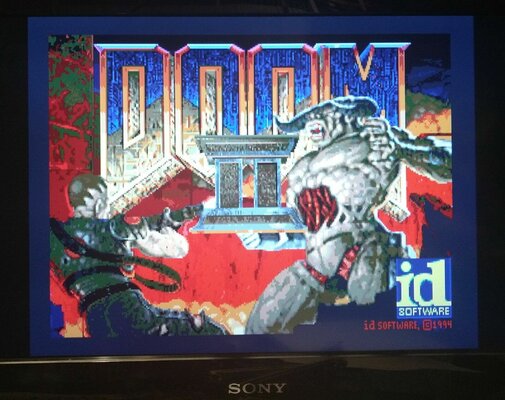

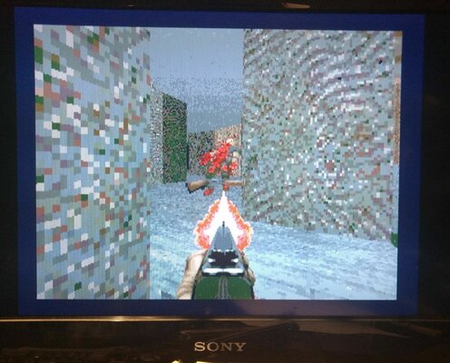

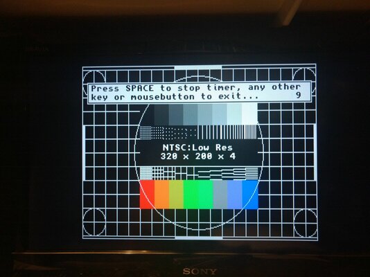

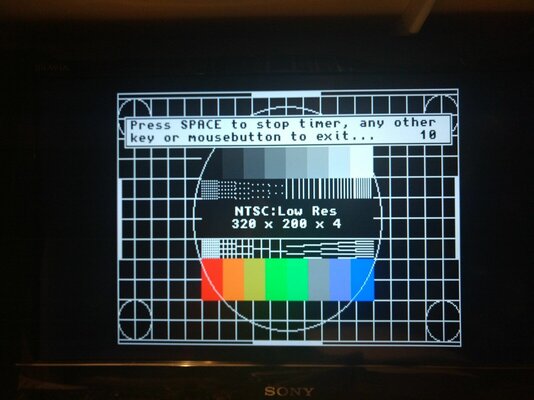

@Jameson done some testing with the NTSC & PAL Screen modes and they all came up and I even loaded Adoom in NTSC 320x200 and it loaded up fine

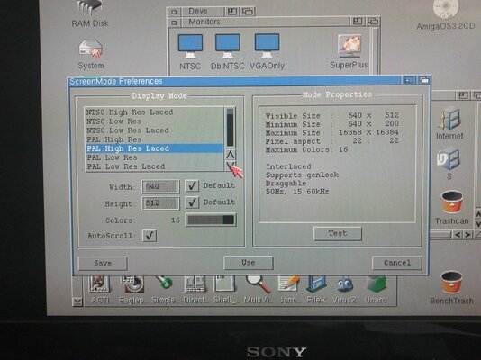

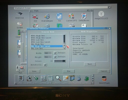

However I can't seem to add superplus or HighGFX to my screenmode options I'm not sure if this is because it is a CDTV or if AmigaOS 3.2.2 is not allowing them to load
I've added some pics sorry I broke my phone and I'm using an old one so picture quality is not the best sadly
The monitor is a Sony Bravia PS2TV and the RGB2HDMI is set to output at 1024x768 @ 60hz and scaling to a 4:3 ratio

Thanks for that mate - appreciate the time and effort and it provides some good information.
I am running 3.2.2 on several ECS systems and SuperPlus/HighGfx works perfectly on them (Indivision ECS), so it can't be a 3.2.2 issue.... not sure if you need BOTH a 2MB Agnus AND an ECS Denise to get access to HighGfx screenmodes - can anyone confirm? If you DO need both, then that would explain why you cannot access them on your CDTV (assuming of course you have not upgraded you Agnus and ChipRAM to 2MB).
If the combination of a 1MB Agnus and ECS Denise can access HighGfx screenmodes then it means the RGB2HDMI cannot handle those modes.... which means they are totally useless to me. :(

My CDTV has a megachip clone so that's not the issue I believe it's ECS. This issue I'm having is getting the modes to even show up in screenmodes I only get the NTSC & PAL options to choose from even though I've placed HighGFX and Superplus into Devs/Monitors, so it probably something I'm doing wrong.
Ah, okay. That's weird. Silly question, but they are in your Devs/Monitors drawer?
Yep as stated prior
I put all the others in to like VGA only but I still only get them two options
Hmmm, I remember having this issue on a system ages ago, but I cannot remember what caused it or how I fixed it. Let me have a think about it.
Do you have any monitor driver loaders in your SS?
If you give me a few minutes to wake up (had a Sunday layin' today) I'll get some screen shots for you. Be about 15 minutes
Right showered, woke up and got a coffee ☕ and in the messy mancave.

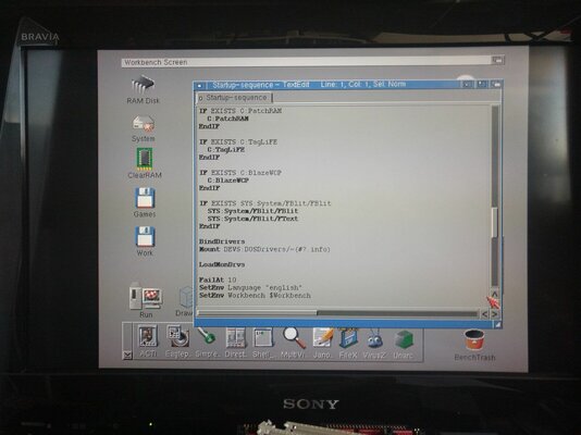

CDTV loaded and here are some pictures showing the system and screenshots
As you can see no other options I've had a similar issue when installing RTG cards, if I remember correctly that required an addition line in the Startup-Sequence wonder if it's the same added a pic to show it just has LoadMonDrvs in SS
