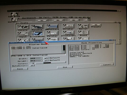

Could we please have some screen shots? Including close ups? Bonus points for 24bit AGA screen shots :thumbsup:
I took a few pictures, but most of them are too blurry, because I haven't used the flash :dry: Here's a workbench screen shot.

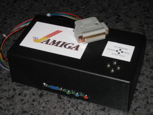

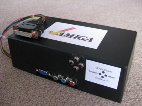

my box but want a smaller one
got some micro switches now too

what i was thinking about doing john was doing away with the rgb cable altogether and have the plug on the box itself to make it more compact and shortening the cable so the hole unit plugs into the desktop case,then using plungers thruogh the case to the buttons on the pcb,making the height smaller.just sourcing a see through box at the mo.i think for mine ill go for a red one if i can get one in the right colour if not ill make one
Some quality screen shots would be brilliant!.
Along with something AGA!.
4 colour workbench screens doesnt cut the mustard. Really keen to be blown away by the crisp picture from this device!
