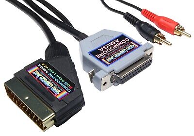

I use one of these:
With one of these cables:
Sometimes You can get good picture even with such SD/FF, but monitor has to have good pixelclock/phase adjustement range.
Regarding the "VLR" adapters, your mileage may vary with each monitor, but it is also important to have the adapter with good filtering capabilities.
I use one of these:
No scart or hdmi option on my monitors. My best option due to space limit is to share a monitor with my pc. Pc to vgi and Amiga to vga.
Of course cannot have them both together..
Clock or phase just moves the lines across the screen. So I must decide if like the lines here or there 😭
I have about 2-3 monitors more, so I can test them soon.
If you want the best picture quality , then buy an Indivision MK3, OSSC or Retrotink 5x. These devices are built for Retro gaming consoles and computers. A Scart to HDMI converter is only attended for VCRs and DVD players.
