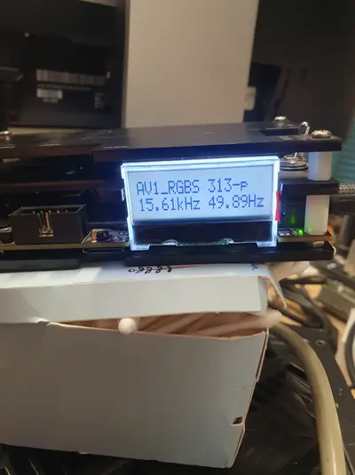

Going through an OSSC:
No lines!

So going through the OSSC:
Needs further investigation :D
The 23pin to VGA solution works on every other Amiga I have, so the OSSC is doing the lifting work here...
This is standard behaviour when using A1200s on 15Khz capable Dell monitors via one of those adapters in my experience. You can try adjusting clock/phase to see if it improves but I have never managed to completely solve it.
I had similar experience with Dell. First of all, I'm not sure 15kHz is even officially supported by their monitors. While the internal hardware does, the quality is questionable. In my case I also used a good shielded SCART to connect it to OSSC, and had no such issues back then. I also tested same monitor with another A500 - it was not that bad, but you could still notice some vertical artefacts. And non of the RGB-VGA dongles helped completely.

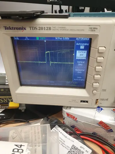

Continuing the journey of discovery, out of curiosity, I wondered if the interference was on one or all of the colour channels. I pulled each of the ferrites in turn, and the interference was across all of them. So, it appears that the interference is from the source of LISA rather than downstream, which could be a number of signals entering U4.
U23 and U32 have similar signals of those from a 1D4 that I'm currently using as a reference.
A couple of the signals were jittery, but no different to another Amiga A1200, I think I will take a look at the signals into Lisa tomorrow and have a look at the clock phases as mentioned earlier :D
** Note: _MLD from U34, _BCAS_XX from U20 Budgie, SCLK out... 14Mhz out, 28 from U20 Budgie, CCK from the usual CBM bodge...
