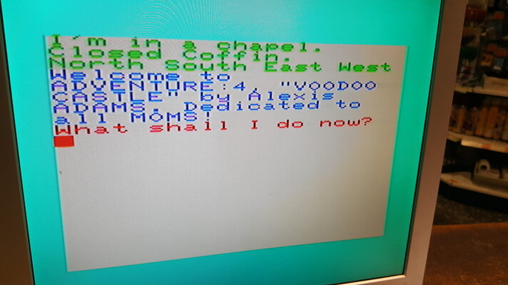

Here is an image of how my Vic works with the cable. The LCD isn't very good but the quality is GREAT !!!!!!!!
My assumption is that previously you couldn't play Scott Adams adventures, as the text was not readable?
