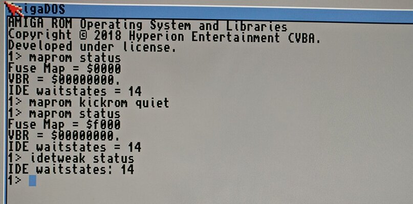

Oh, this card has MapROM function built in, so basically You can copy any ROM Image in it's memory and run it:
Here is official thread: (You need to be signed in)
https://www.a1k.org/forum/index.php?threads/62419/
here is translation:
To use MapROM - use following tool: (attatched)
Code:
MapROM kickrom quiet
This copies the built-in ROM into the RAM and activates MAPROM. A reset is not necessary.
If you want to load other ROM files, you have to
Code:
MapROM kickfile <file>
enter and do a monkey grip (soft reset)
Note: The software comes from @Scrat including an automatic reset from @Bubbob

UPDATE 01/14/2020
New MapROM tool
The following things can be done with it:
KICKROM: Loads the built-in ROM into the TK memory, where it can now be read with 13MB/7Sec
VBR2FAST: Loads the interrupt vector base register ins fastram. That makes the Lady even faster!
KICKFILE <file>: Loads the specified file as a kickstart and does a reset
EXTFILE <file>: Loads the specified file as an extended ROM (CDTV and 1MB ROMs) and does a reset
DIAGFILE <file>: Loads the specified file as F0-ROM and makes a reset
FORCE: Ignores read-only ROM regions
REMOVE: Removes all ROM overlays
STATUS: indicates the current status of the configuration
WAITSTATE <number>: Sets the IDE waitstates to the specified number.
FUSE <hex>: Sets the fusemap for read / write protection (see below)
QUIET: Eliminates all expenses
If Maprom is already active, it ignores itself and issues a warning level 5 so that you can react to it in the startup sequence.
