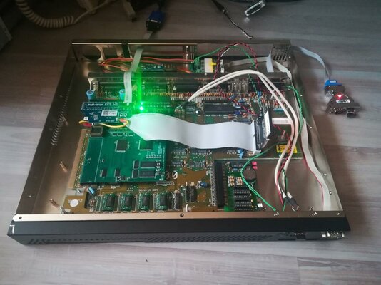

Accelerator received today.
It's a great board and pretty fast. The accelerator matches perfectly in my rack mount case project and there should be enough space for a GBAPII++ in the future... :)
